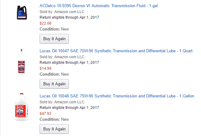

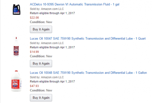

I did this about a month ago for the first time and was super easy. I got everything off amazon for cheaper than i could buy locally plus if you ever need to prove receipts amazon keeps track of all your purchases.
The rear diff i reused the gasket when i pulled the cover and had no issues.
Front diff, remove skid plate and there is a drain plug and fill plug.
Transfer case is drain plug and fill plug.
One thing to note is the manual says to fill to .5-.8" below fill plug i believe on the diffs, so i did the method of draining, measuring the amount that came out and put the same amount back in. Unless you have a leak this works great.
And always remove your fill plug before drain plug just in case there is an issue with the fill plug ( shouldn't be but never know.) that way you don't drain the fluid and have no way of filling back in.
