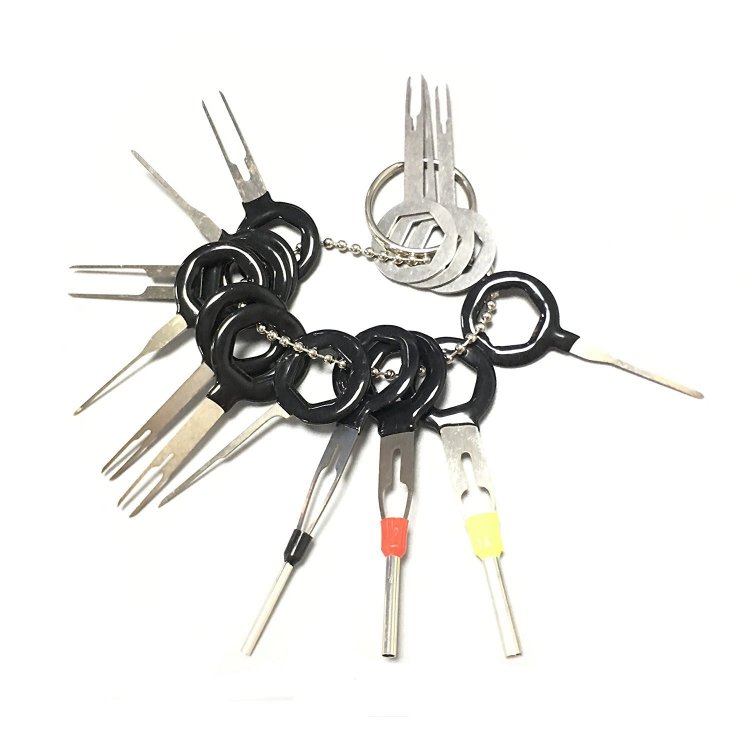

What pins and connector did you order and from where? Was it a 2018 pin and connector?
I order the parts shown in gamboa's post on page 9 with the pictures. They are for the 2018 module. The part numbers are on the bags and I used Mouser Electronics just like he did. I have everything in my possession , now waiting for the deep freeze to end so I can work on it without freezing my fingers off. You definitely need the connector and some have had success reusing the same pins but I ordered new ones. Unfortunately they can only be had in lots of 100 so i have many extras...
Do you have the 2018 parts they should fit without issue. Some splicing is needed that’s it. I also ordered the wiring bundle from Gambia’s post on page 9. He’s helpful and quick to respond.
No splicing is necessary. We used a pin removal tool and then just inserted them into the new plug.  Same orientation.
What is a pin removal tool,  I broke a connector trying to remove it from old plug.  As soon as my new connectors arrive tomorrow, I will try again.  Also, the red part on the new plug slides back and forth, does it need to be in a certain position?
They come in a set of assorted sizes and allow the pins to be removed without damage by compressing the locking barb. The sliding part acts as a lock.
