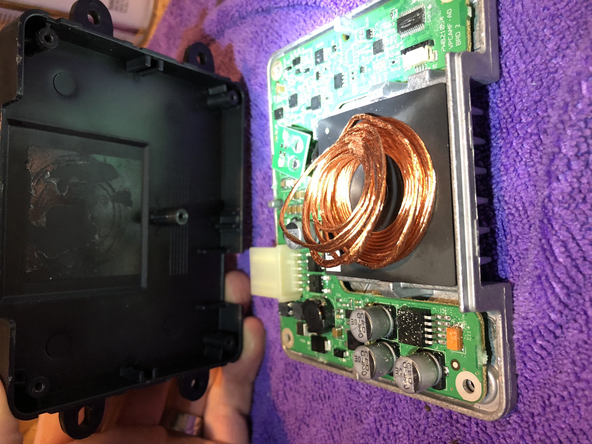

Unfortunately I tried this and failed. When taking the module apart there was a ton of adhesive on both sides of that thin plastic shield and it stretched out my coil of wire. The adhesive on that plastic was stuck to the cover and stuck to the copper coil of wire. It even tore the thin plastic shield thingy.  I used a hair dryer to warm it up some to try and loosen the adhesive which helped some.   There was no damage to the coil of wire that I could see. So I carefully pressed it back in place but after reassembled it would not work. And I did remove the magnet too. I did notice the tag on my plastic shield I removed said 09-17 and the one in the video I beleieve said 13-17. Maybe they are different modules?  I have a 2017 Sierra HD Denali. I placed the phone right on the module before reinstalling and it wouldn’t connect at all. Prior to my modification it would connect for 3 seconds or so, then disconnect and never charge. Maybe I’ll try ordering an 18 module?

I THINK it's more of a "repeater" it's just a magnet... Which Is what's used to charge.
ALSO- I think some phones aren't capable of rapid charge- iPhone is.
Lastly, you can lay your iPhone directly on the actual charger it will not charge with that piece move it and lay it on the coils and it charges... It simply blocks the signal for iPhone 8&10
Unfortunately it didn’t work for my iPhone 8 when I removed the magnet and thin plastic film and laid it directly on the charger before re assembly.
Mine didn't either... Not even on top without the rubber mat... I put the rubber mat in, turned truck on, viola.
BUT IT is very specific on placement... Mine had to be at the bottom of the pad.

Second, I removed the thin plastic piece from my 16 Tahoe and yes, my iPhone 8 will work, however, the only way it works is if the phone is sitting on the charging mat when you start the vehicle (or power up in the accessory mode) - if power is on and you drop the phone on the mat, it will not work.  Not sure why, but this seems very odd to me.  I completely blame GM for this problem and hoping they will either find a fix for it soon or at least allow consumers to "upgrade" to something that works.
You've got this apart does the 6 pin harness have a 5v or 12v source? I ask because it might be good to buy a good Qi charger on Amazon and see if you can retrofit it in place. Sure the green icon won't show on infotainment but who cares the phone will show it charges.
TRY TURNING THE PHONE ON... As in unlock it and go to home screen... AFTER the truck is on as you suggested.
Mine is the same way... BUT if I flip it on first it'll work.
I don’t think I tried that. May have to pull it apart again and try!  Any special way the phone has to be sitting on the mat?
Mine needs to be on the mat at the very bottom.
FOR ME- once the phone has connected one time (that trip) it always will connect.
I have to start the truck flip the lockscreen open and set it down... after that it’s good to go.
I have a 2016 Sierra All Terrain X and just got the iPhone X.  I went ahead and followed your instructions and removed the plastic/magnet piece and the phone will charge sitting right on top of the charger/black box but when I install everything and try the phone on the rubber mat on top of the lid I get the little green lightening bolt on the screen for maybe 3 to 5 seconds and nothing happens with the phone.  I tried to unlock and put it on there while unlocked and I still get nothing.  It seems like the rubber mat is too thick maybe.  My rubber mat is the one with ridges so it does raise the phone up a tiny bit.  I am testing the phone with no case too.  Is there anything else I can try?  I really dont want to pull out the rubber mat.  Any suggestions AlabamaBishop?
