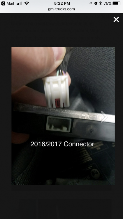

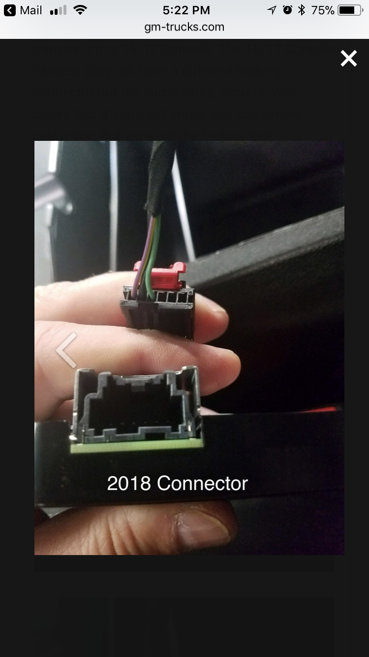

Thanks so much for posting this information--very helpful!  I do have a questions.  You mentioned that the new charger module uses the same 3 wires as the old one.  Are those 3 wires used in the same place and in the same order on the new module?
So I received part number 571-2035363-4 from Mouser Electronics today - the plug is the same exact plug that is in the 2016/17 vehicle now?  How is this going to connect to the new module - if we ever get it - on backorder with no ESD in sight???  Are you sure you gave us the correct part number?
No. It uses the same 3 wires but the actual plug is different for the 2018 module than in previous year modules. Look back through this message and see the photos user Pgamboa posted of the different plugs for the different years.  I believe it is around page 10.
I realize that it uses the same 3 wires - however, the part number he listed for the connector (571-2035363-4) is the same connector that is used for the 2016/2017 modules - not the one for the 2018 module.  I need the part number for the 2018 module.  And I don't have a "page 10" so if you can repost that thread I would appreciate it.  Thanks.
I just checked my order for mouser. That part number is the correct connector for the 2018 charging module. I have a 2017 truck and the connector I removed from my truck was not the same as this new one I installed. And the connector that was on my truck would not plug into the 2018 wireless module   Although I did read somewhere that someone was able to force it on somehow? I didn’t try that hard as I had the new correct connector.
Okay - now I see the difference - I don't have the module as of yet (since it is on nationwide backorder) but was told that the 2018 module had a "4 pin plug" vice the "6 pin plug" like the 2016/2017 versions.  Now that I look closer I see the plug looks similar, but the configuration is slightly different.  Thanks for sending the photos - they were a big help.  Now we just need to get the module back in stock.
