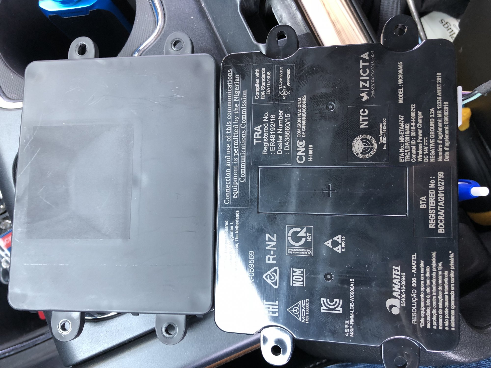

I just received my 2018 wireless charging module for my 2016 Chevy HD and verified that it DOES work. The plugs are different but with a little bit of coaxing, it does plug in and work flawlessly with my iPhone X. In the photo, the charger on the left (that didn’t work with any iPhone) is the factory 2016 charger and the right is for a 2018.
I used the vin number from a 2018 vehicle on their lot that I verified did work with my phone before I ordered the module for that vehicle.
I did verify my charge percentage increase 1% over 5 minutes charging time.
I also verified it will remain charging even though the bottom of the phone is sitting about 1/8” above the charging pad because of my bulky Otter case.
$114 at the dealer including tax.

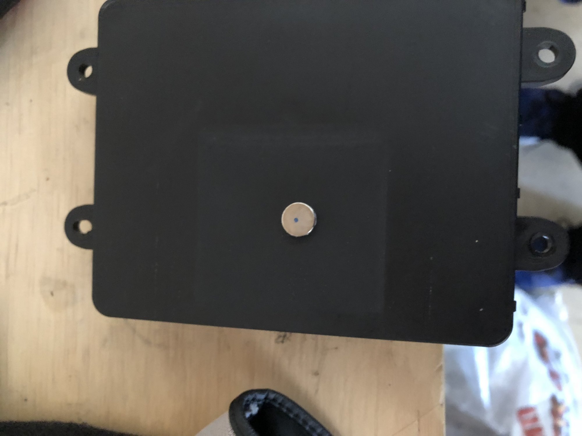

The process of removing the inner piece from the video isn't exactly right. The real problem is the tiny magnet in the center. In the two part video the guy fails to mention in the first part he left it in, in the second he removed it. I left the sticky other piece attached and ONLY removed the tiny silver magnet in the center and it works perfect with an iPhone X.  Attached some pics.

This is what the magnet looks like. Be careful prying it out to not damage the coils.
This is what threw me off too and after watching it several i noticed the magnet missing in his.  I took my magnet and now it "kinda" work...like it only charges when I turn the truck off and start it back with the phone sitting there.  I guess I'll go back and remove the magnet but put the flex board piece back in and see what happens.
