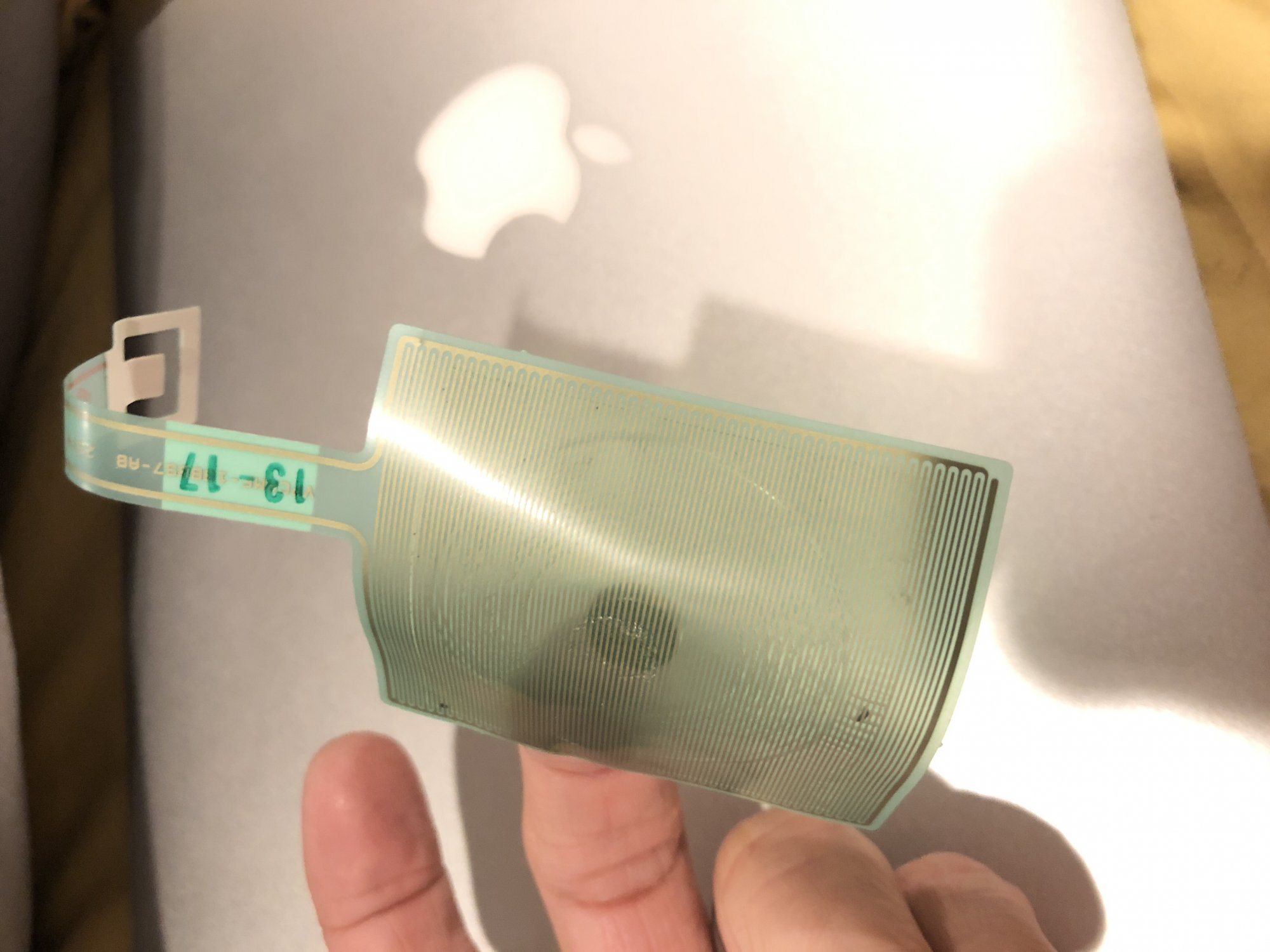

11 hours ago, David Ulbrich said:
So, does anyone know what that piece actually does?  Does it act as a regulator or something?
I’m thinking it may be some type of switch/safety mechanism to keep the charger from turning on when random metal objects (keys, etc) are placed on the console.
