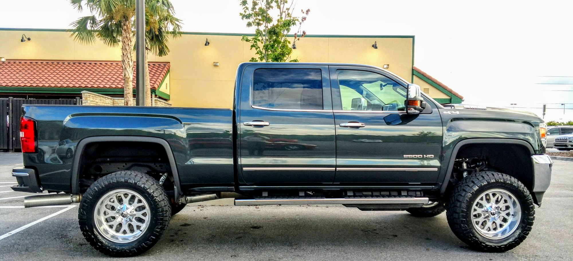

I have the 6.5in BDS lift. No complaints here. 35x12.5 Toyo AT. It's a tad bit slower on acceleration, but I'm not into racing trucks. I don't tow or plow. It's a road princess. I would have purchased a 1500 if it hadn't been for the AFM, so a 2500 was the only choice for me. With everything I installed it was a hair over $7k. Lift, wheels, tires, and labor.
I've driven over 25k miles on these tires, and will probably get about 15k more. If I don't get another set of 35x12.5, I'll probably get 295/65. Haven't decided yet.
