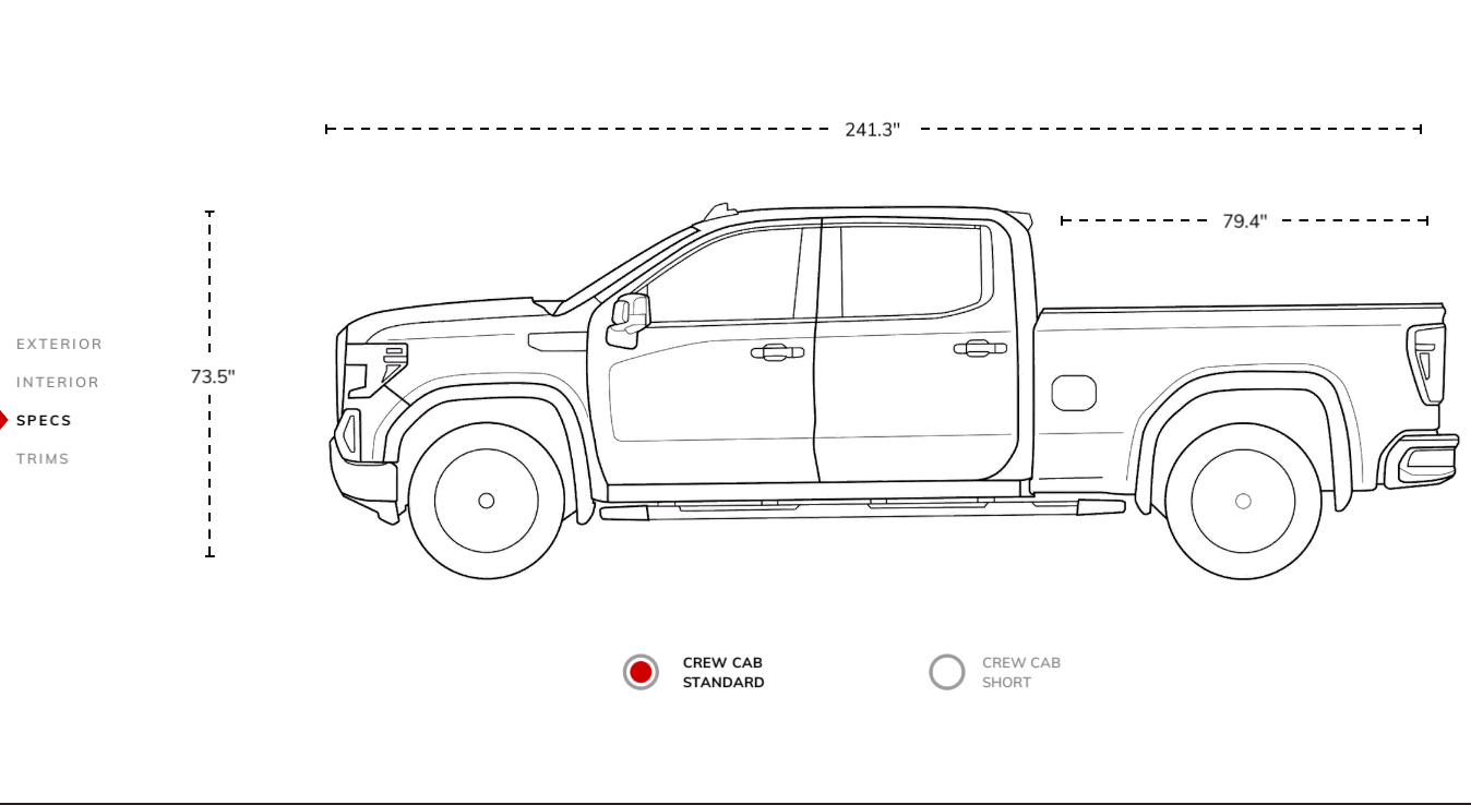

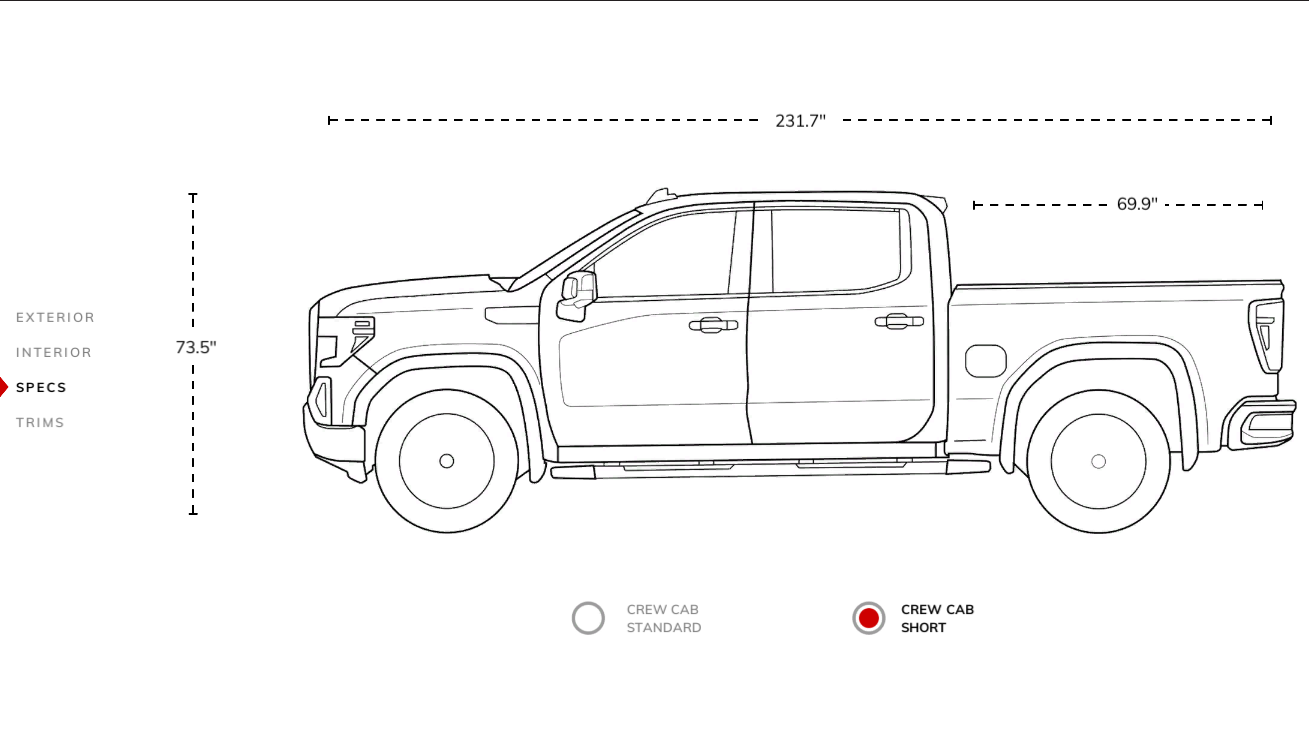

They definitely got something wrong with those dimensions.
2019 crew 6.5' box can't be 205.5"
A 2018 1500 regular cab 6.5' box is 205.6"
A 2018 Canyon crew (212/224) is longer than what GM posted for the 2019 1500....????
I emailed gmc about the incorrect dimensions for the 2019.
educated guess:
Crew cab short bed overall 230-231”
Crew cab standard bed overall 240 - 241”
1 hour ago, amxguy1970 said:
I am 6'5 and can sit behind my driving position without touching the seat backs, the cab didn't need to grow, kids had no use for more room, but now the truck is with in an inch of not fitting in a standard garage for what? Wonder if the bed length got any shorter to help find those extra inches for the back seat passengers?
Tyler
GM moved the front wheels forward and shortened the engine bay to enlarge cab. Bed lengths did not change but truck grew lengthwise by 1-2”.

K2xx 2014 - 2018
Crew cab short bed 229.3” overall - Cargo Box length 69.33"
crew cab standard bed 238.9’” overall  - Cargo Box length 78.87"
T1XX 2019+
Crew cab short bed 231.7” overall
crew cab standard bed 241.3’” overall
http://www.gmc.com/trucks/2019-sierra-1500-pickup-truck#signupforgmcupdates
