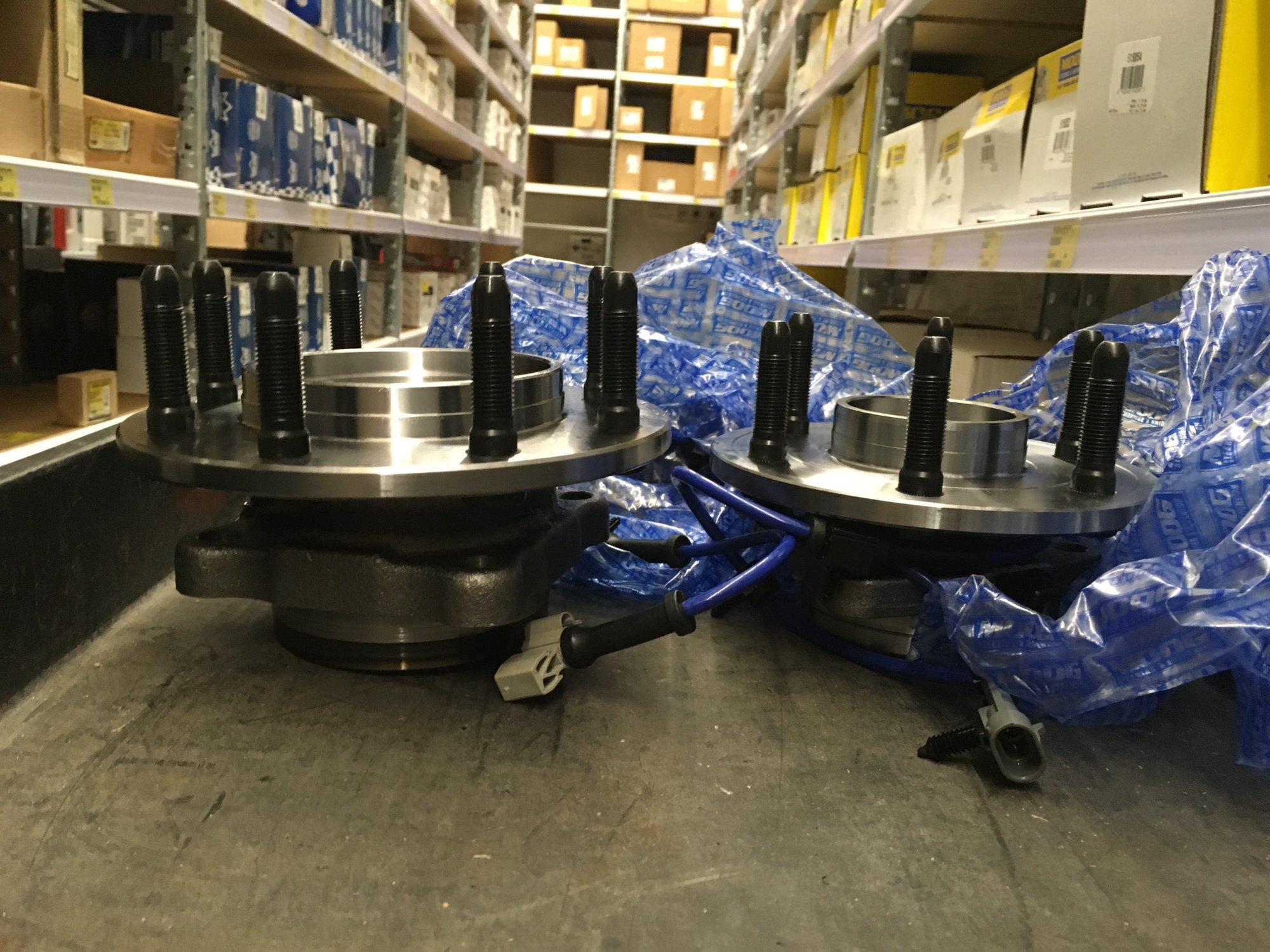

I've owned a 1/2 ton for about 5 years now and i know 3/4th suburban owners. Every reason you should get the 3/4th ton is a heacache i've had with mine. The 8.65 rear end, the 60e, the weaker frame, front axle. The g80's in the 1/2 ton always blow. The 6.0 has an external oil cooler and hydroboost for brakes. The 2500 wheel bearings weigh almost 1.5 times as much as the 1/2 ton and are 4 bolt compared to the weak 3. The 2500's are easier to work on underneath as well because of the frame setup and suspension. The 6.0 mpg isn't too much worse. If you plan on keeping the truck i'd get the 2500. I sure wish i did. Today at work i actually looked up the wheel bearings to compare and look at the size difference.
The 2500's have the 4l80e FYI. For the cost of repairs on the 1/2 the 3/4th will pay for itself and save you in the long run.

59 minutes ago, 02suburbanZ71 said:
Wow, that's quite a difference.
I never would've thought the 2500s were that much larger.
