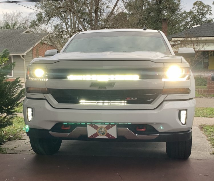

It can be done if you buy led light bars that aren’t deep. I have a 30” and a 20” installed.
Edited by jaxsilverfox

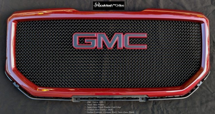

On 1/29/2018 at 4:10 PM, DenaliLegend said:
Has anyone had a problem with this, replacing the grille? I just purchased a new grille and want to install but now worried I might run into a problem. Here is the grill
Where did you get that emblem?!  I have been looking for this exact emblem for my trucks grill!!
What's the throw like on that top bar? I have a Diode Dynamics 6 inch bar where you have that one and it basically doubles the headlight output on high beams. I'd like to fit something wider in there though.
What brand are these light bars?
Not sure the brand. These are great for the flood portion and seem to light up everything in front of the truck. I’ll get some shots when I’m in the mountains end of month.
