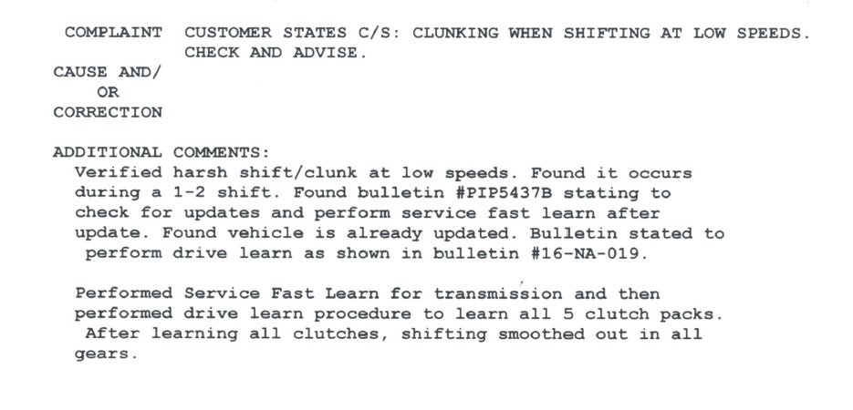

Pretty much been living with the 1-2 shift clunk since new, 12,000 miles on her now.  Thought she was due for oil change mileage wise, made appointment for service, snapping drivers side armrest and clunky tranny.  Turns out it was only at 26% on the oil - they changed it anyway.  Snapping sound from arm rest - new part on order.  1-2 clunk they did a "drive learn" per bulletin PIP5437B and 16-NA-019.  So far - so good.
When I picked her up I asked if they thought driving it around town in M7 (to keep her out of V-4) affected shift "learning", and they recommended against it.  Said it will be "relearning" my driving habits for 2,000 miles.  So probably not going to use manual mode except when needed for grade braking, towing etc.  Told them these trucks need a switch to turn off V-4.........

Certainly no clunking - been sticking to no unnecessary M mode - but only a few days driving since fixed.  With the louder muffler it helps to hear the shifts by RPM change.  You want to talk butter - our 2015 and now 2018 Subaru Outback sure shift seamlessly - U never know when they shift..........

Nope - Right back to low level clunking - even down shifting to 1st sometimes feel it.  Seems to be the new norm with GM.........  As my salesman says...... "They all do it"..................
