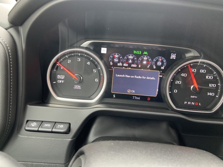

Anybody with nav on their new truck? Every time I load navigation it says the memory card was removed. I have a memory card in the reader in the console and it doesn’t seem to read it.
Any  help appreciated.
I have formated and tried Fat, Fat32 and NTFS with no luck
I also have placed music on the memory card and it plays the music fine, so the memory card reader is functioning
