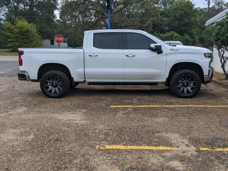

Thanks! It has been a crazy week but she sits high and pretty now :)
The shop (#OakleyOffroad) set the shocks to 4 and it's great. She doesn't have the boat feeling driving on the freeway or going over bumps. They advised to bump it to 8 when I tow or go up to the mountains.
Im sure I'll tweak it up or down a notch to find that sweet spot. It's nice to have that flexibility.

Finally got a pic during daylight hours! ?
Haha, thanks, I definitely like them. Gonna save this pic for some future inspiration in case I decide to upgrade wheels.

1 hour ago, lapoolboy said:
Put exhaust tips on and washed it
Looking sharp!  The wheels you picked are a excellent match to the truck, great choice.
I have that identical truck and those are the best looking wheels I’ve seen on a white truck. Well done.
