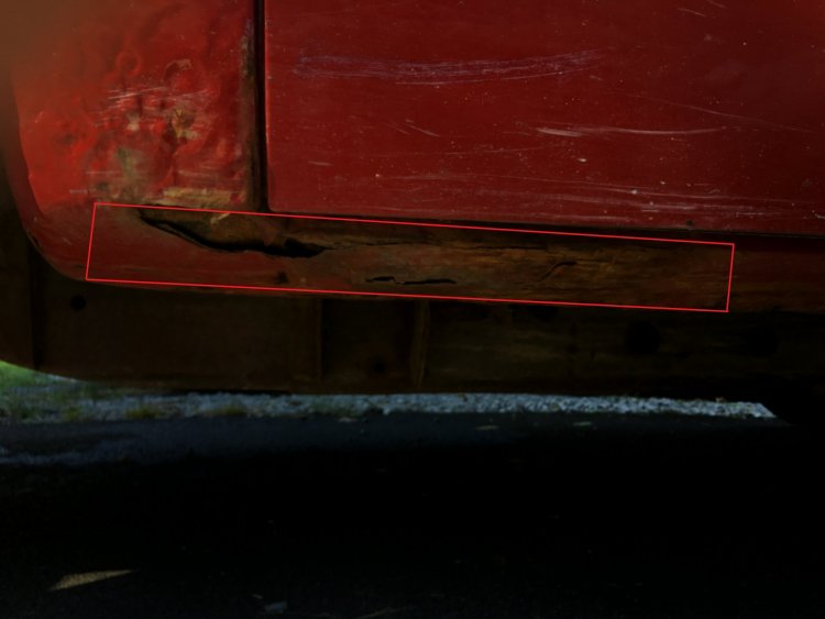

Sorry it took so long guys. I am focusing on getting my transmission oil changed out right now. Which can only be described as a pain in the @$$. I have a detailed thread of how that project is going on here as well. Anyway these are the only pictures I have taken thus far as the body goes. That entire area that I marked with a red box is now completely hollow. I just applied a little pressure to it and it easily collapsed. I will take another photo showing what I am dealing with now.
I realize I will now be fighting an uphill battle as it rusts from the inside out. However, I might try to purchase some of that mesh netting from Bondo and fill it in with the other filler material they sell, paint it Victory Red, and hope it holds up for awhile. What do you guys think?
That’s not bad.   I knocked out rust, power washed the inside and sanded or cut away most the rust i could.  I then unloaded rust inhibitor inside the rocker when it all dried.  The power washing sort of cleaned out the weep holes in the rocker and it was amazing how much flakey rust blocked those up.
I now just deal with it and ignore it.  Everything else on the truck is decent
You put bondo and mesh on that without addressing some of the rust, it will just spread and bubble next to your bondo job and it will be a waste of time and money.  Worst scenario, the rust festers while sealed from the outside and rots your inner rocker panel.

Thanks for your responses guys. I just took a picture of what it looks like now that I cleaned some of the rust out of that location. It was literally just flaking off, I am surprised that it did not give way while driving it. It does not look good, but not particularly bad either. Anyway it will give a better idea. I just took this other picture of my truck too. You probably cannot believe that it is the same truck.

Not a body man, but here's what I'd do if you have access to a small MIG welder. Cut back the rusty parts to good metal. That's going to open up some body cavities. Use a good rust converter (as opposed to a rust inhibitor) on everything you can reach inside. CRC makes a good one. Then use the rust inhibitor on top of that. Weld in new metal, using the converter/inhibitor on the inside before welding. Sand the welds down, do the converter/inhibitor outside, then paint. It isn't a guarantee of stopping the rusties, but it's about as good as you're going to get.

Yeah I understand, I think I feel more like greatmizzou in that I do my best to ignore it. However, I would like to get some of the structure back and possibly paint it. Then be happy with that for several years before looking at a new truck. I have not welded since High School either, but guess it is never too late to learn again.
My father said to put a piece of sheet metal there and rivet that in, and fill it in with some bondo. I would be happy with that even if the rivets were sticking out and it was a little uneven. That side of the truck you see in the picture is where the hole is. So you cannot see it without looking under the truck right now. So restoring some of the structure and holding off on any extra damage for as long as I can is really my only goal.
