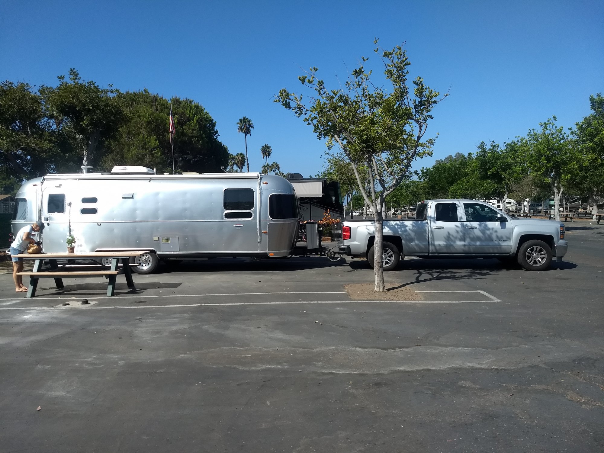

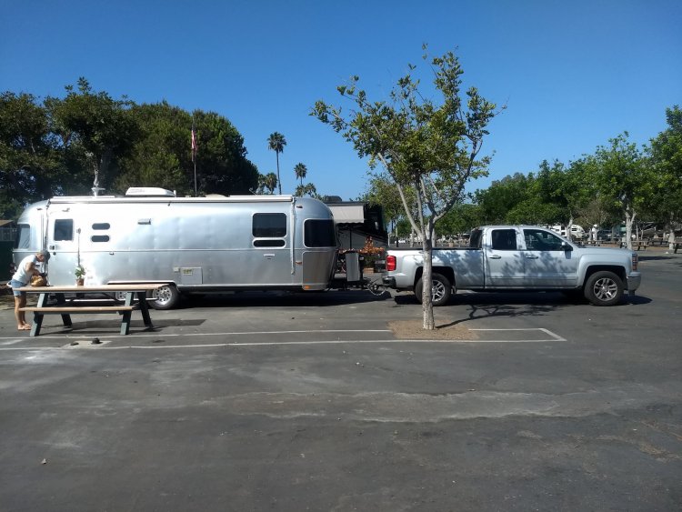

I tow a Airstream Int'l Sig 27FB 7600 GVW initial trip weighed in at 6900 lbs with my 2015 Silverado 5.3 with the max tow package rated at 11,200lbs.
