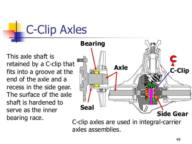

The axle shafts are held inside the axle tubes by C-clips inside of the diff. When there is a little play, the axle shafts can slide side to side just enough to make a noise. When you push sideways on the truck, the axle shafts (attached to the tires) are held in place, so the whole axle housing (shafts and pumpkin) slides sideways.
It's a normal characteristic of a semi-floating axle. Some make more noise than others depending on tolerance stacking.

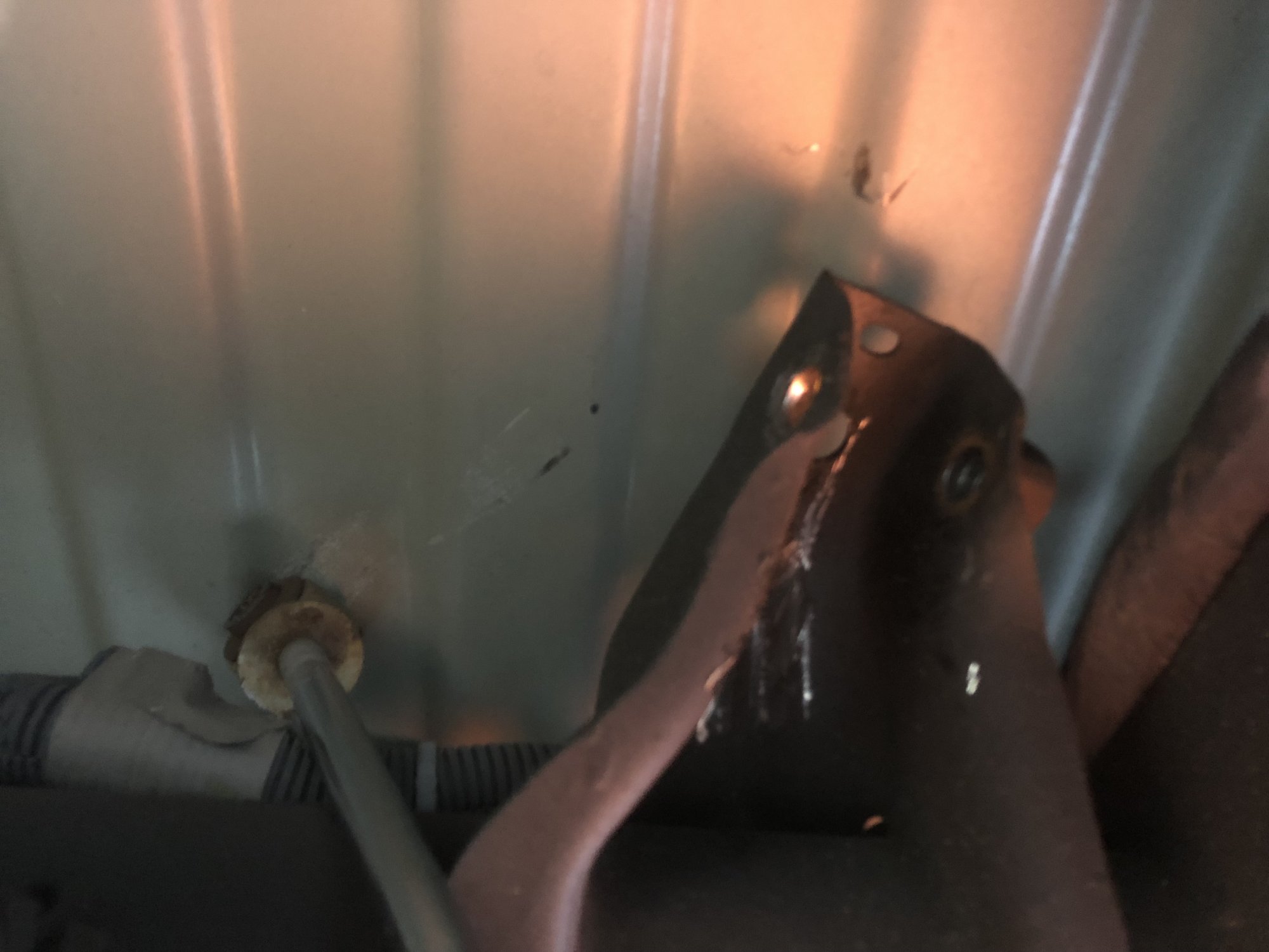

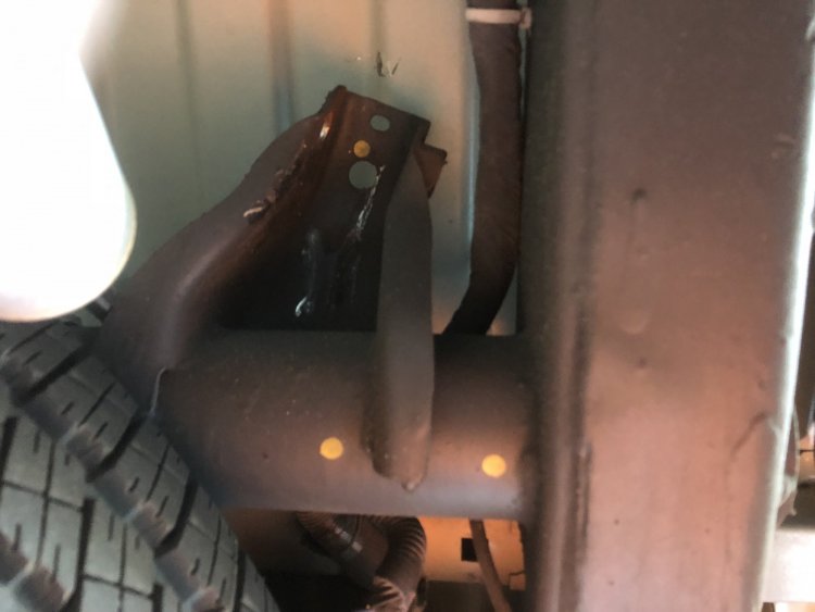

SO... found the issue...  Shock bolt broke or came loose and the shock... well... see the pics...   :/
I then went to the local dealer and looked t a few used trucks and 1 of 7 had a loose shock.   Bolt was still there but was loose.
Thank you for the detailed explanation. I wasn't sure if I was being hosed.
