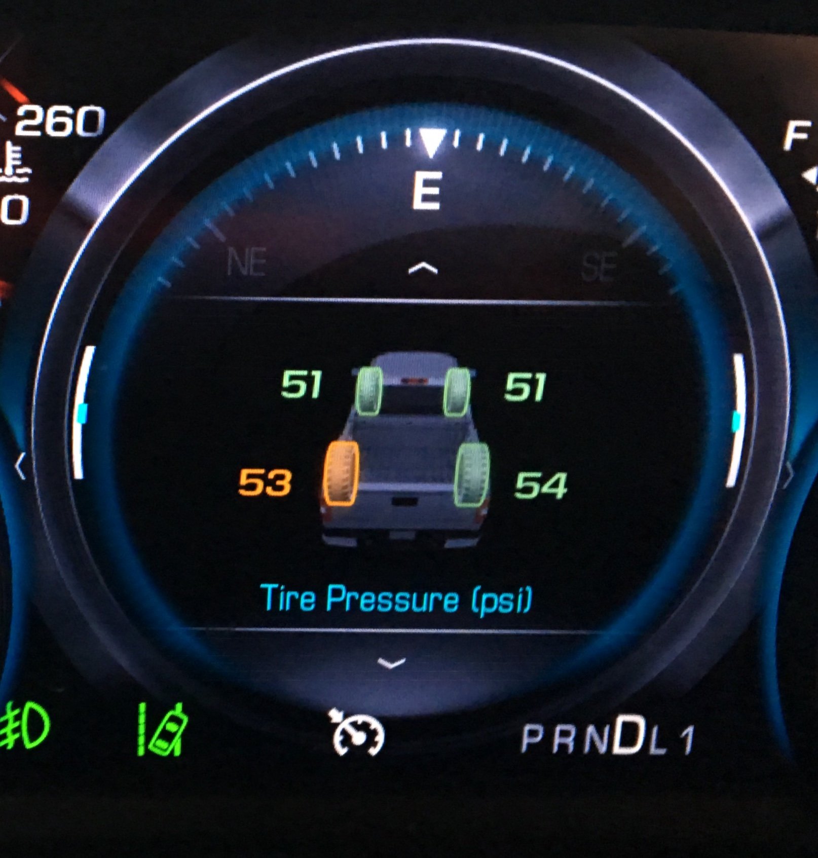

I have aftermarket wheels and tires. I want to run my tire pressures at 55psi. Can the dealer reprogram for that?

My door says 60 front and 80 rear. I tried running them at 60 and the light still comes on. At 62 it’s fine until the temp drops at night.

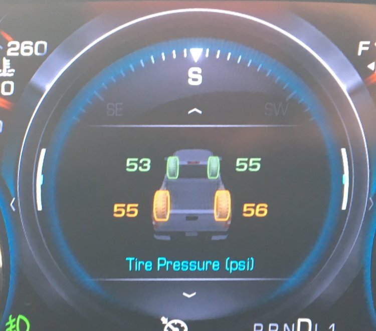

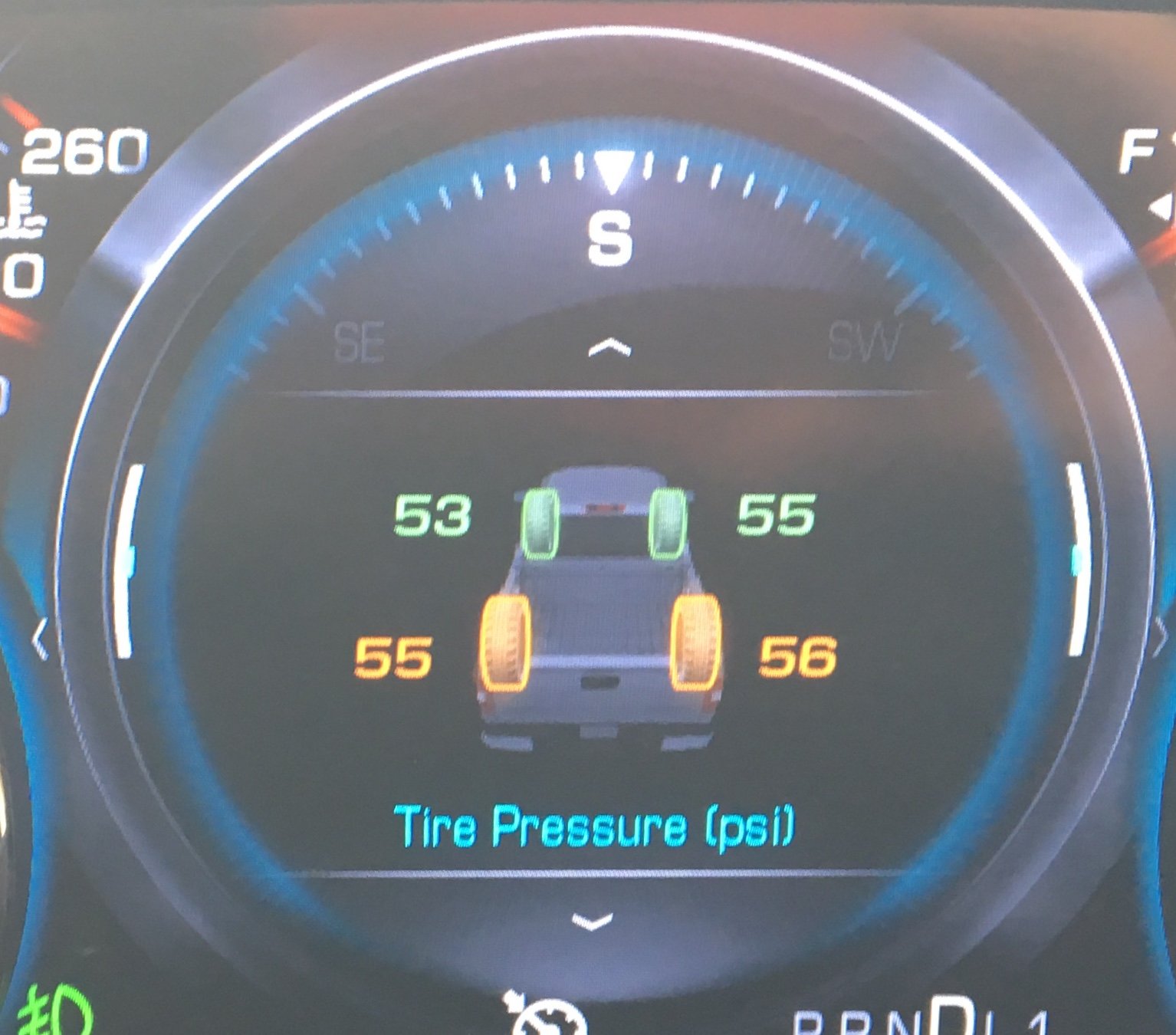

Warning for pressures seem odd to me. I was not towing so I lowed the psi to 55 all the way around then weather temps went colder so psi reduced. Warning at 53 but not 54....then next time I shut truck off warning at 55 and 56?   So when I was back home I filled them up to about 65 before they turned green. Now I have front at 55 and rear at 60 when not towing (70 rear when towing).
