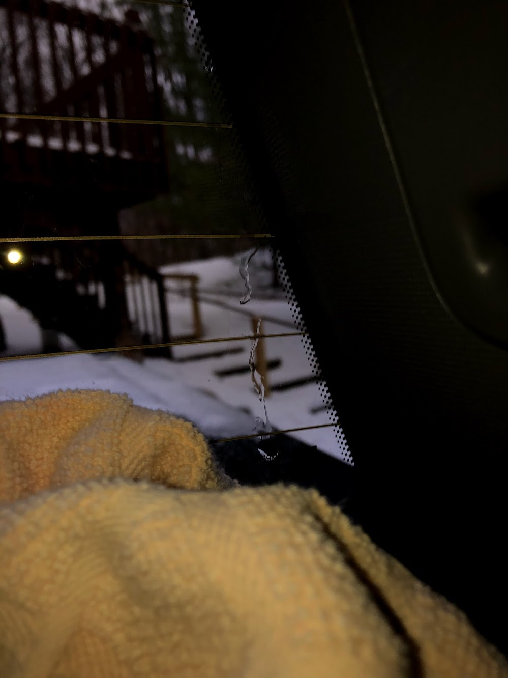

2 hours later on the way to Traverse City (still in light rain) my daughter notices water on her shoulder in the rear driver seat. My son check his side and water there too. I blamed condensation and turned on the defrosters but there was a steady line of water coming in the rear driver's side. Droplets were on the passenger side sliding window frame.
I had my daughter put a small rag in the corner to soak up any water. It rained on an off for 2.5 hours and every time it rained, water entered. And I found this forum... For those 2.5 hours I was on here trolling,  getting angrier and angrier.
