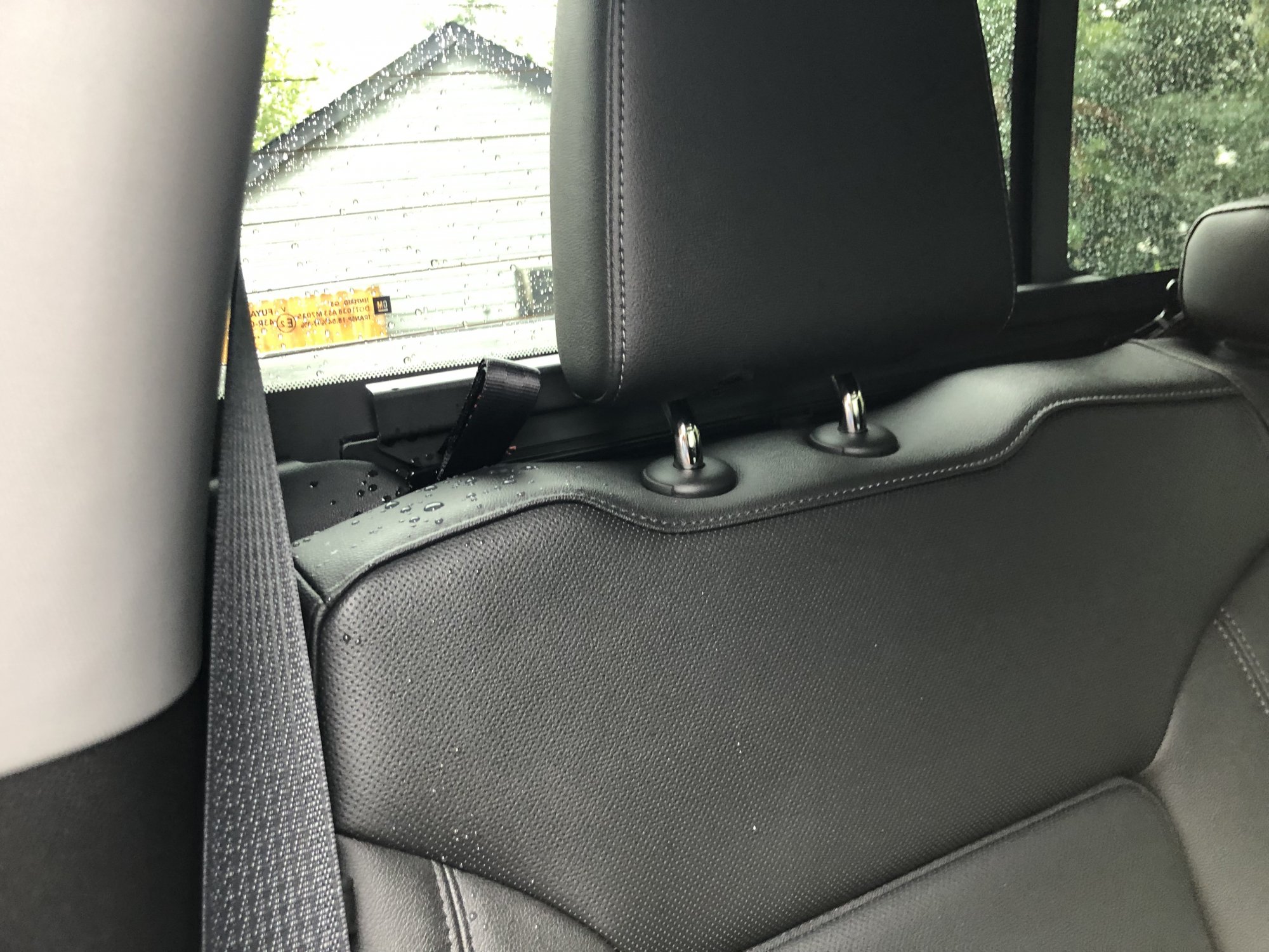

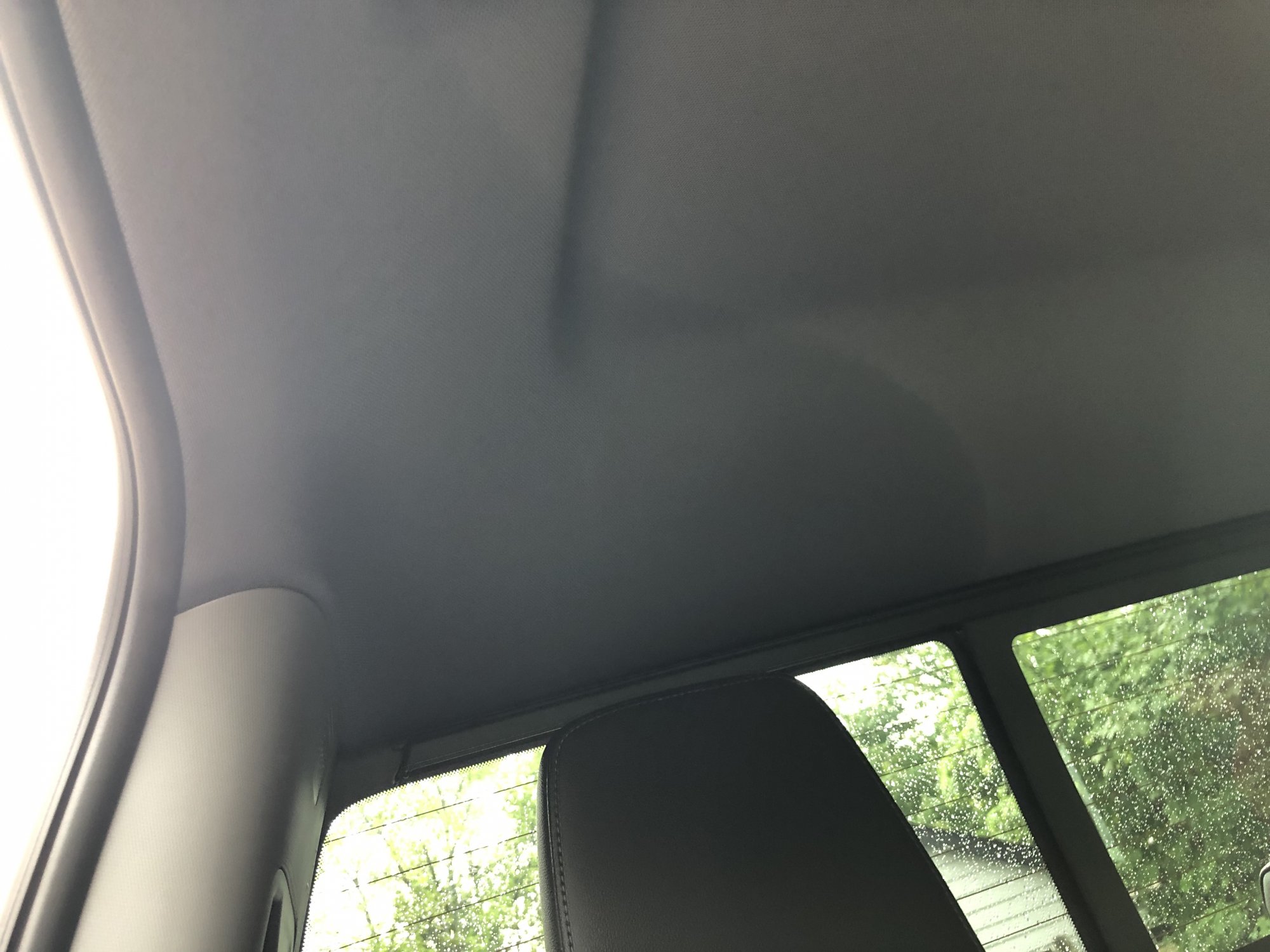

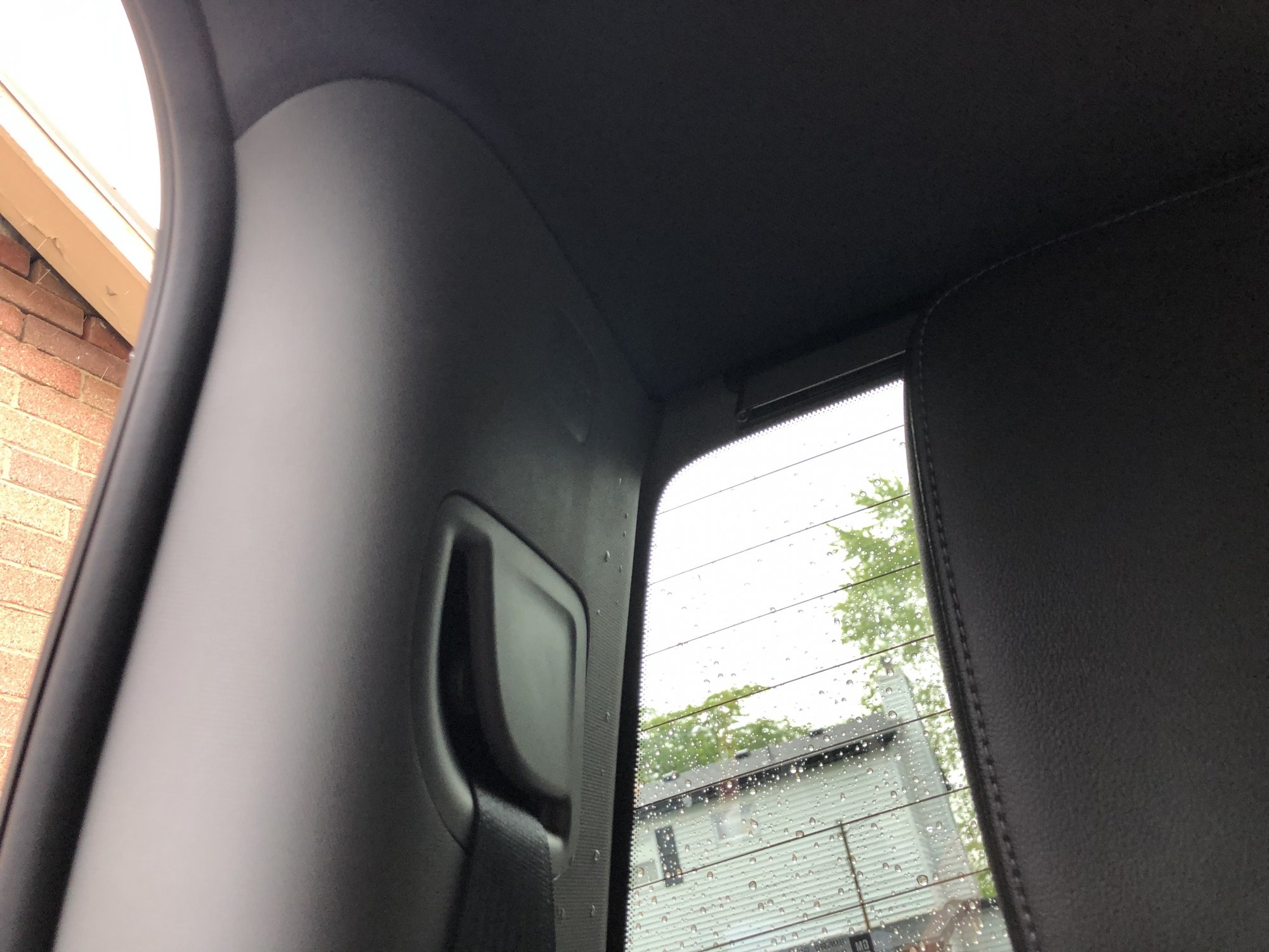

Sorry to be late to the game but where exactly should I be looking for this?  Does it only show up with water on back seat headrests?  If I put a hose to it (not sure this is necessary as I live in Oregon)  where are the key areas to check for the leak?  I came onto this tread a little late and I am way too lazy to read through all 60 pages.
Headliner, seats, pillar, etc.
639CD085-4556-484C-89AF-4718DB27CF51.thumb.jpeg.33aad2d7b420244ad49d0ba8d70179e5.jpeg28DC98CD-F6B0-4732-8426-C6D51FD3BEE0.thumb.jpeg.54a02b25965bb5ceb4dca01f70b92639.jpeg9BA8AE35-19BE-4E91-9DBE-8FEB0051C401.thumb.jpeg.c4bfb59ba6d524152199f7b3a6faeec7.jpeg
It ain’t hard to spot once you look for it. Garden hose may or may not uncover it. Just check after some steady rainfall. If it don’t leak yet, it probably will.
2019 Silverado High Country, built in Indiana, May 2019. Lots of rain led to me discovering water on my drivers side rear seat shoulder. Appointment is made for tomorrow morning... we'll see how it goes.
Update, got the leak sealed. Picking up tomorrow, I'll update how it goes. Crossing every limb i have. This sucks gang
Got my leaking window re-sealed on December 26th. Had a good long, steady rain 2 days later. No leaks.
Took it thru the automatic car wash today. No leaks. Surprised, to be honest. I still don’t think the re-seal will hold long term, but who knows. I have a Feb 2019 build, so maybe it will.
