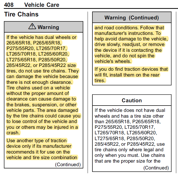

Thought I'd do a general search online to see what kind of traction devices I could get... Was looking at the König XG-12 Pros, or other like items and noticed this little tidbit in my User manual...
Having the Midnight edition with the 265/65R18 Duratracs... I guess I'm out of luck, unless I go with studded tires or I guess get a lift?
Owners with these size tires and factory lift, what are you doing?

by the first post every size gm puts on a pick up cant use chains i have to agree with the other guys i got k02's and they definately do the job
I believe those of us with 255/70r/17 standard GM size tires are safe with chains.  I often carried chains with my 2wd trucks but never found the need with good quality all seasons and 4wd.  If snow and ice were a greater concern, dedicated snow tires on separate rims would be my choice over chains.

What do you guys do in mountain areas that have certain times where chains are mandatory?
I carry a set of cables for those times. Very rare in Colorado that they will activate “code 16” chains required on everything. 3PMSF tires, “3 peak mountain snowflake” and 4 wheel/all wheel drive will get you over the big passes in Colorado and meets the requirements of code 15 “passenger traction law” I carry the cables to get through the State Trooper checkpoints.
That makes sense, thanks for the info.  I've been traveling from NC to Colorado and Tahoe the past few summers and have seen the checkpoints.  Definitely want to move out that way,  the mountains are amazing.
