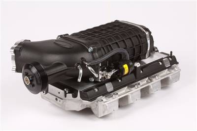

Superchargers still have a manifold. Don't know why you would think they don't. It is under the charger and connects to the heads charger mounts on top of that. This is the spot one of the maps reads from to measure boost in bars. Like when you hear people say I have a 3 bar map.
Centrifugal superchargers mount in a way that the stock intake is left on the engine.

The superchargers for the 5.3 replace the intake manifold (integrated), they don't bolt to the top of them. I'm not referring to a centrifugal supercharger, they are not easy bolt on's for the application we are talking about. During installation you remove the intake manifold and install the supercharger, it is a roots or screw type supercharger. I don't need you to explain any type of intake configuration, ive been doing this way to long.

I guess Magna charger is wrong and you should write them a email to help them out. Because it is called a manifold in there decryption of the part. and that is the are that has the sensor port for the one of 2 map sensors. Please see pic.

 unless you are calling every part a supercharger even thought as stated it is NOT called that(see pic).
