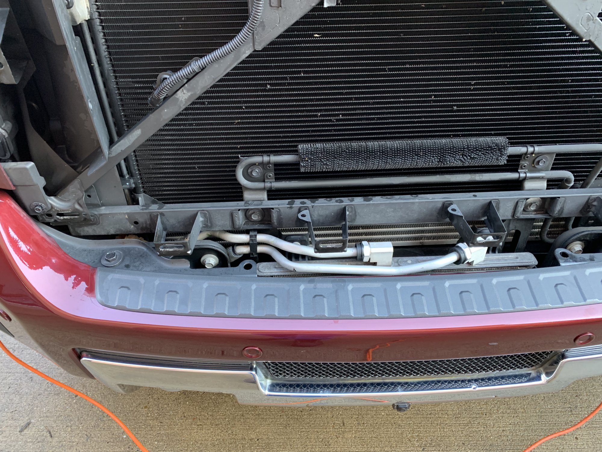

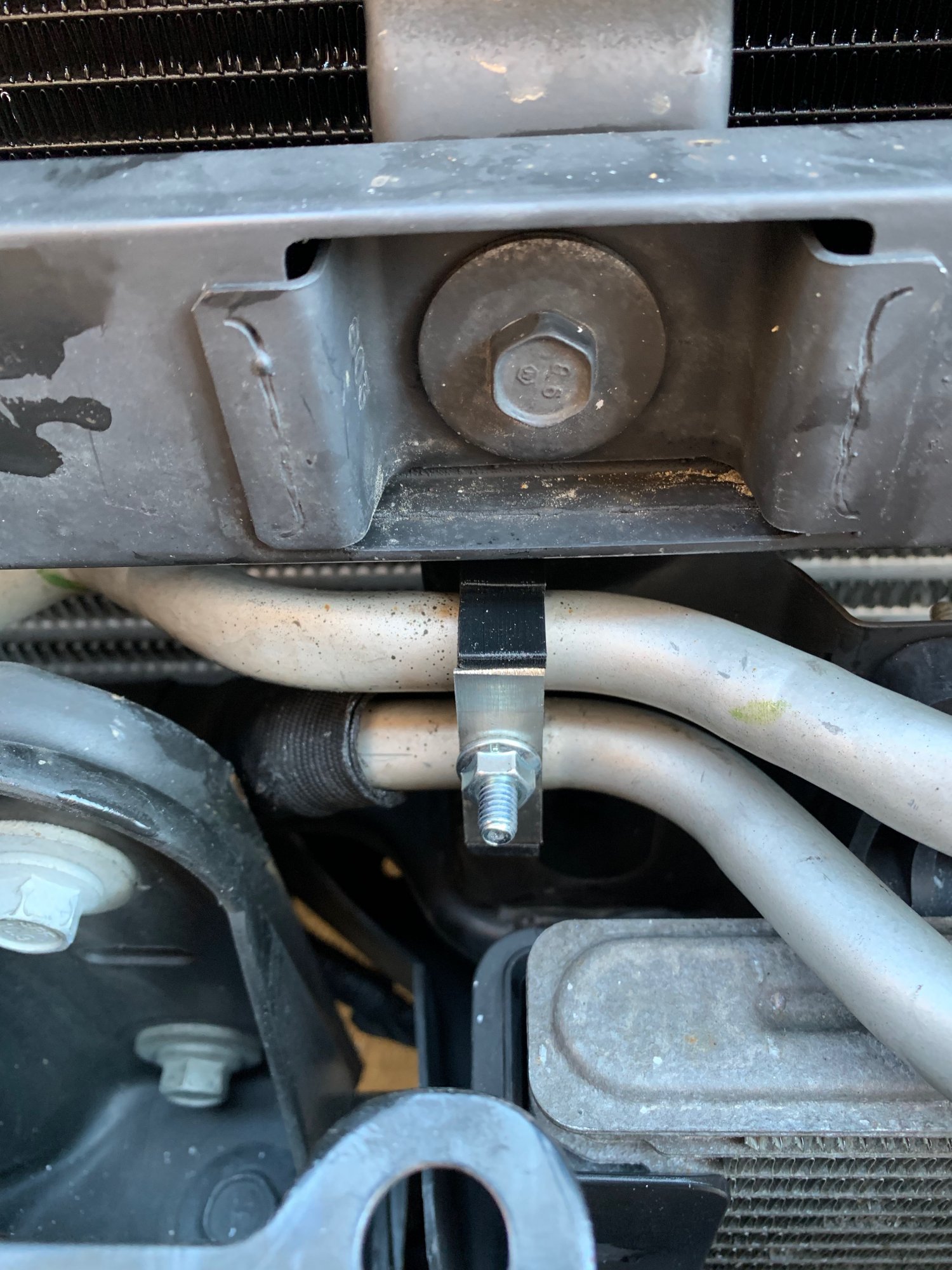

I installed the new bracket today.  Very easy and it holds the line about a 1/4 of an inch off the bracket.  Here is a picture of truck with the grille off of it.  The factory bracket is in the lower left corner of the picture.
New bracket.  Notice there is about 1/4 inch of clearance now between the lower line and frame.  The factory bracket is a flimsy piece of plastic with a push pin holding it to the radiator support.  This product uses stainless bolt and nut to securely pull the lines against the radiator support.
The directions that come with the Deviant product are very clear.
