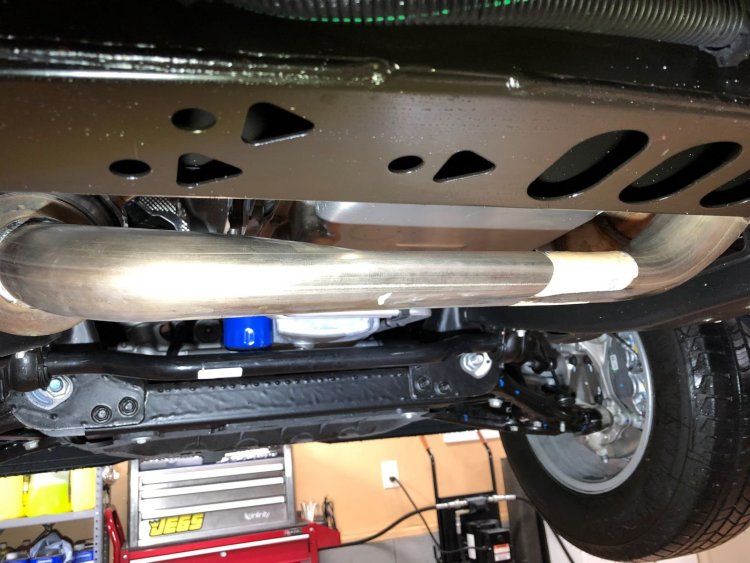

The first item is what I'll call typical GM compromise in design with the left side exhaust downpipe. As this pipe makes its transition across the transmission, they had to collapse the pipe for clearance issues (see pic).
Nothing like a little extra back-pressure for the left bank. I wonder if the engineer that came up with that design did any calculation to ensure there was no decrease of internal area. I can see this will be a popular mod to eliminate this constriction point.

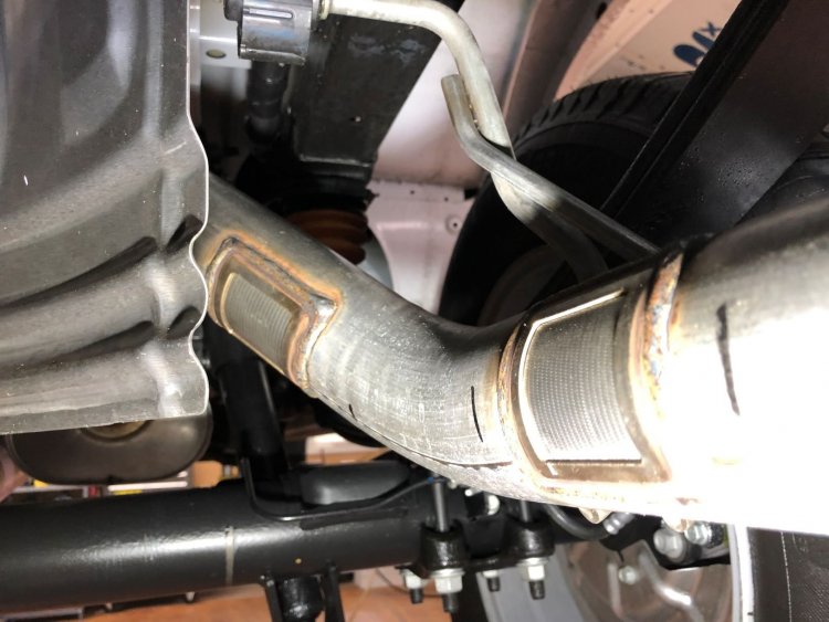

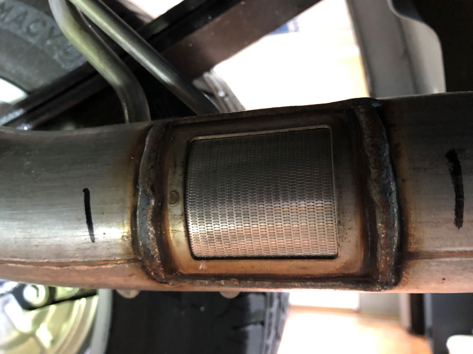

Second area of interest is what appears to be some sort of acoustic stainless steel mesh scabbed onto the tailpipe in two areas. I going to guess that this is some sort of attempt at tuning those ugly power pulses when the DFM kicks in and go's from 8 to 6 to 4 and 2 (see pics).

Learned something new every miunute. Here is the info on the resonance free pipe technology.
https://altairenlighten.com/wp-content/uploads/2018/07/Enlighten_award_slide_module_Faurecia.pdf

The screens on the exhaust I have seen before.  What gets me is why didn't they use them on all the Silverado's?  Mine has regular resonators.  As the link you posted stated, it is a weight savings which is always a good thing.  The only thing I can think of is they didn't work well on a 6.2 exhaust system.
As for the crushed pipe.  If you go over to the C5 Camaro forum, you will find that the pipe doesn't effect HP. Many have done dyno runs with theirs on and with regular pipe and it didn't change.
The crushed pipe does nothing in terms of added back pressure, as it doesn't restrict the movement of the air. In fact, Engine Masters did an entire episode special on power numbers for guys that are scared to bash headers for clearance issues, showing that even on severely mangled/dented headers, you might lose 1 HP/TQ.
Video here (actually quite an interesting test):

Gm has been using the crushed y pipe for over 20 years. Doubt they will change any time soon.
When putting my Longtubes, i chaged the pancake pipes place to behind the transmission (under the yoke)
I saw a great reduction on transmission temps and now it takes a much longer time for the transmission fluid to warm up. The stock pipe literally cooks the transmission pan.

True. But think of the boys that live up north. That same effect will help heat the trans fluid when in -30.

The Mesh basically replaces the old Can style Resonators that date back to GMT900 platform.
They are integrated now rather than an actual separate piece of the exhaust system.
Makes it much harder for a weekend warrior to eliminate it with a Sawzall. :smash:
