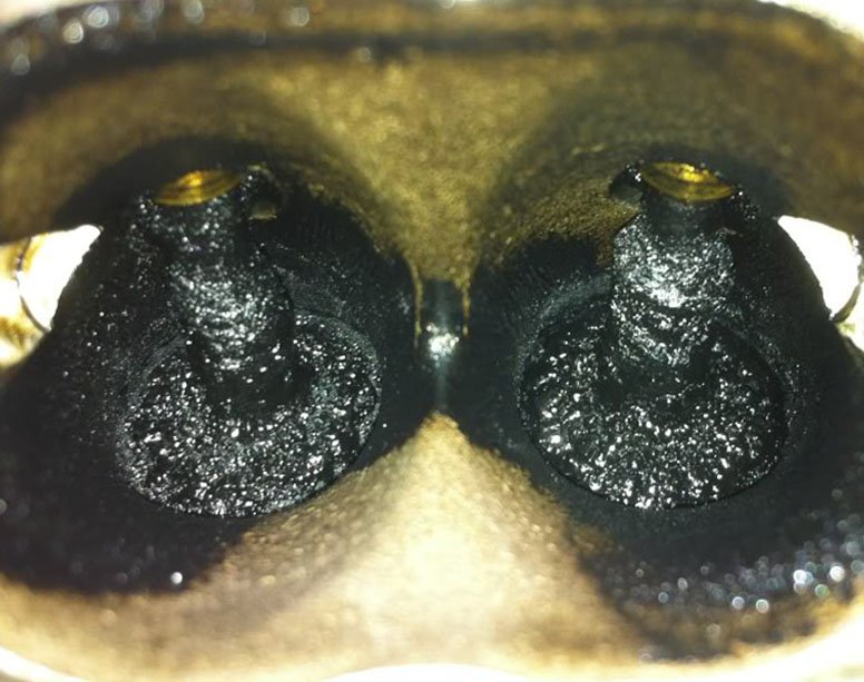

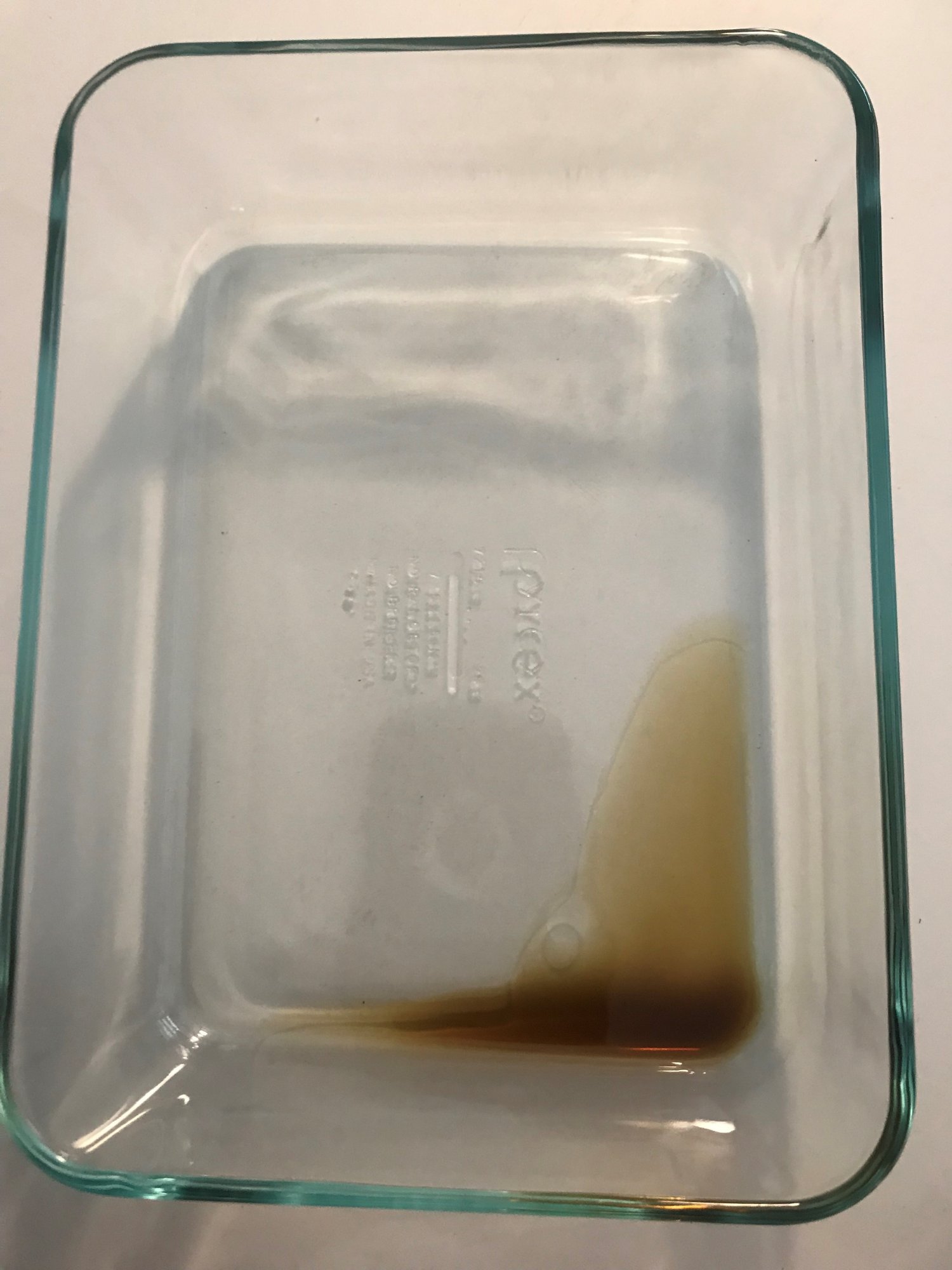

NOT saying they (catch cans) are the end all cure all, but they are being used for a reason...here are some dirty valves and the picture of the oil in the glass is what my catch can caught after just 100 miles of easy driving...multiply that by 50 times and that would be what gets sucked down your intake and through your valves every 5000 miles which is the average oil change interval...nasty stuff.
