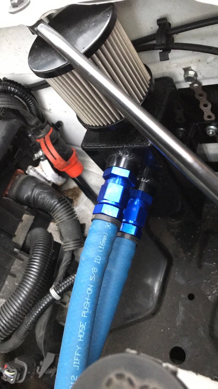

Yes we have. The issue is the small vacuum is nice to give a little negative valve and crank case pressure. But on super and turbo we do both or breather only. I have both on any negative intake pressure once I get boost at all the check valve closes to the intake and the catch can is only under vacuum because the secondary exit line goes to pre turbo intake. But with the can cleaning and the vacuum line so long oil debris cant make it to turbo. Also I have both valve cover port and the css port going to 5/8" that again is long. Goes to a large tank with larger dual port air filters. It is about the most pressure I can let out of the engine without drilling more holes in the engine. Works great.

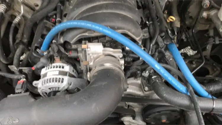

This is what I have set up right now, and I have an elite catch can on order to put in line with the pcv system. I asked my mechanic to install a catch can and this is the style he put so I only ordered the 2 port can from elite

Your n/a so that good. My tank looks fancy but it is a Ebay $60 tank. As I said my exit in catch can closes under boost so it doesnt back flow so the second port on elite can goes before the turbocharger. And that can really suck air. It was whistling LOUD before I got the breather tank.

As long as the exit on the elite goes to the intake manifold that is always under vacuum on a neutraly aspirated engine. The valve covers really just need breathers or open air.
The CCS is tricky because it still gives up some oil so I piped that into the breathers and see no oil issues. Or other option is the dirty line aka the in pot to the elite.
