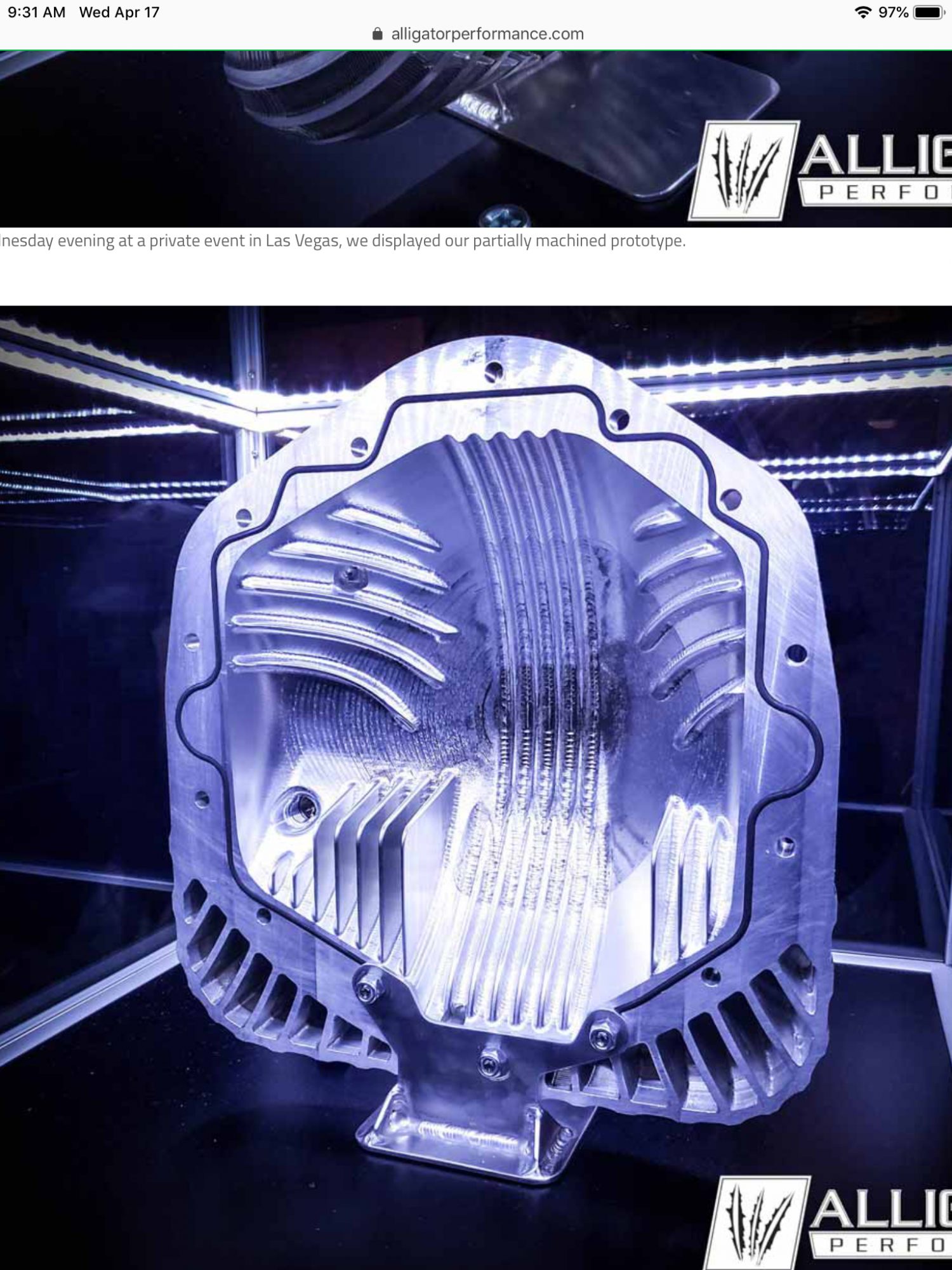

Ok, strong oil scent though, you should look at Rear Diff covers too

It’s got a large drain with a large magnet
Sent from above
Btw, this diff cover is for my 2018 GMC 1500 6.2 with a 323 rear end.
