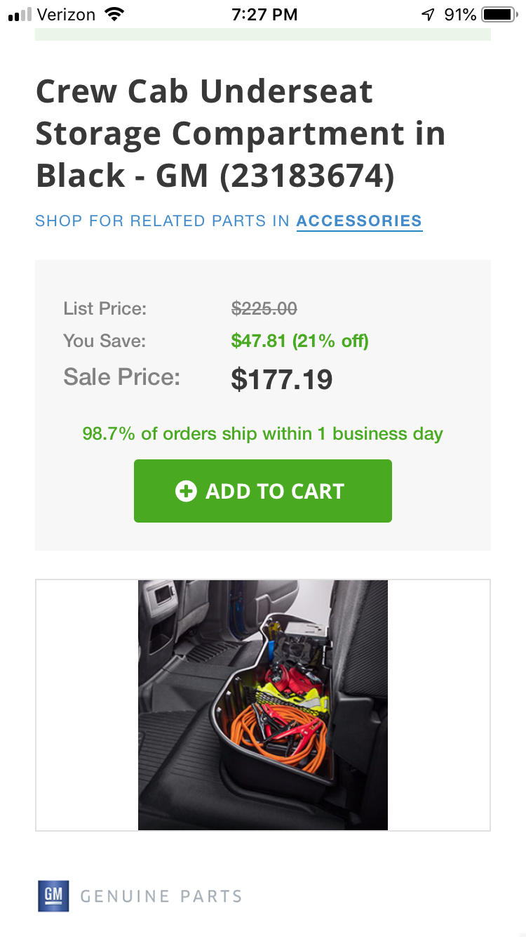

I just had one of these given to me.  Its an OEM box.  My truck didn’t have one in it.  My truck is a 2015 2500 Crew.  The truck this came from was a 2015 Crew as well.  My question is apparently there are 2 brackets that mount this.  One on each side.  The box has 2 holes in each rear corner for the brackets.  The brackets apparently mount to the seat bolts that face up on the floor.  Does anyone have a part number for the brackets?  I’ve looked everywhere i know to look.  I just keep coming up with the storage box but not seeing anything for any hardware.  This is a picture of what i keep coming up with.  Thanks for any help.

Here's a pic of the parts listed for the GM underseat storage, it does look like they could be made pretty easy with some flat bar.
The bracket itself is about 7” long from end to end, but it has that bend in it to clear the floor at the back. That looks to be about a 1-1/4” bent section and it’s at about 1-1/2” away from the end with the floor bolt in it. I’m no metalergist, but even I would try to make these to save the $150 if I had gotten a freebo.
Hope this helps.
