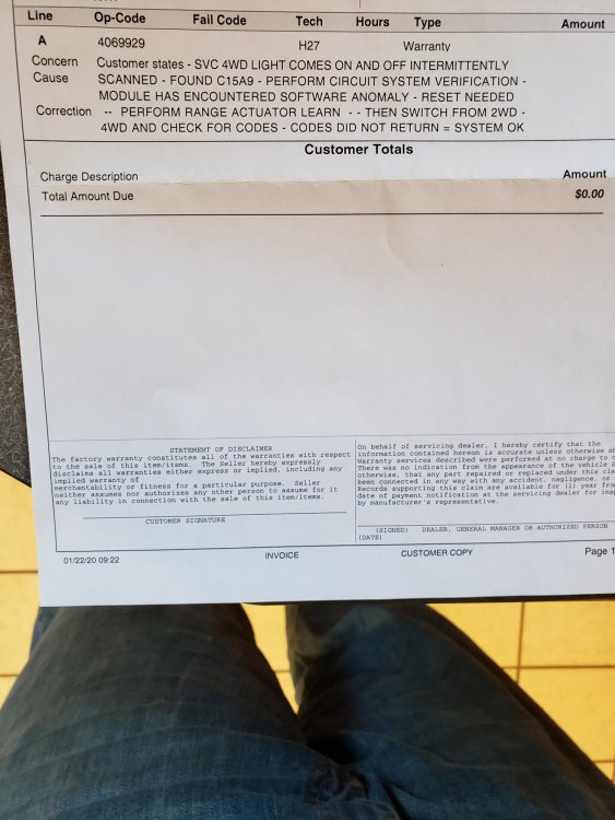

Light went back out after driving for 10 miles. Called dealer this morning and they told me unless the light is on there is nothing they can do. Starting to get really frustrating.

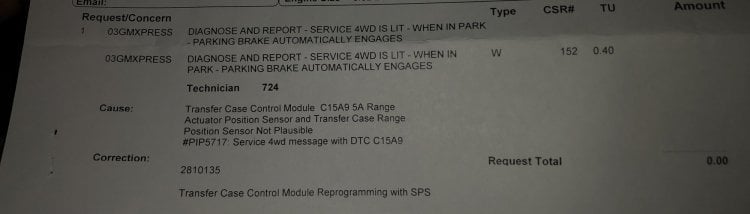

The code that was originally pulled the first time I took it in was C15A9. Is that similar to the codes you've seen on the trucks that came in?
yes as well as C05D2 & P25A2, been seeing few trucks coming in with oil pans leaking aswell as the rear diffs.

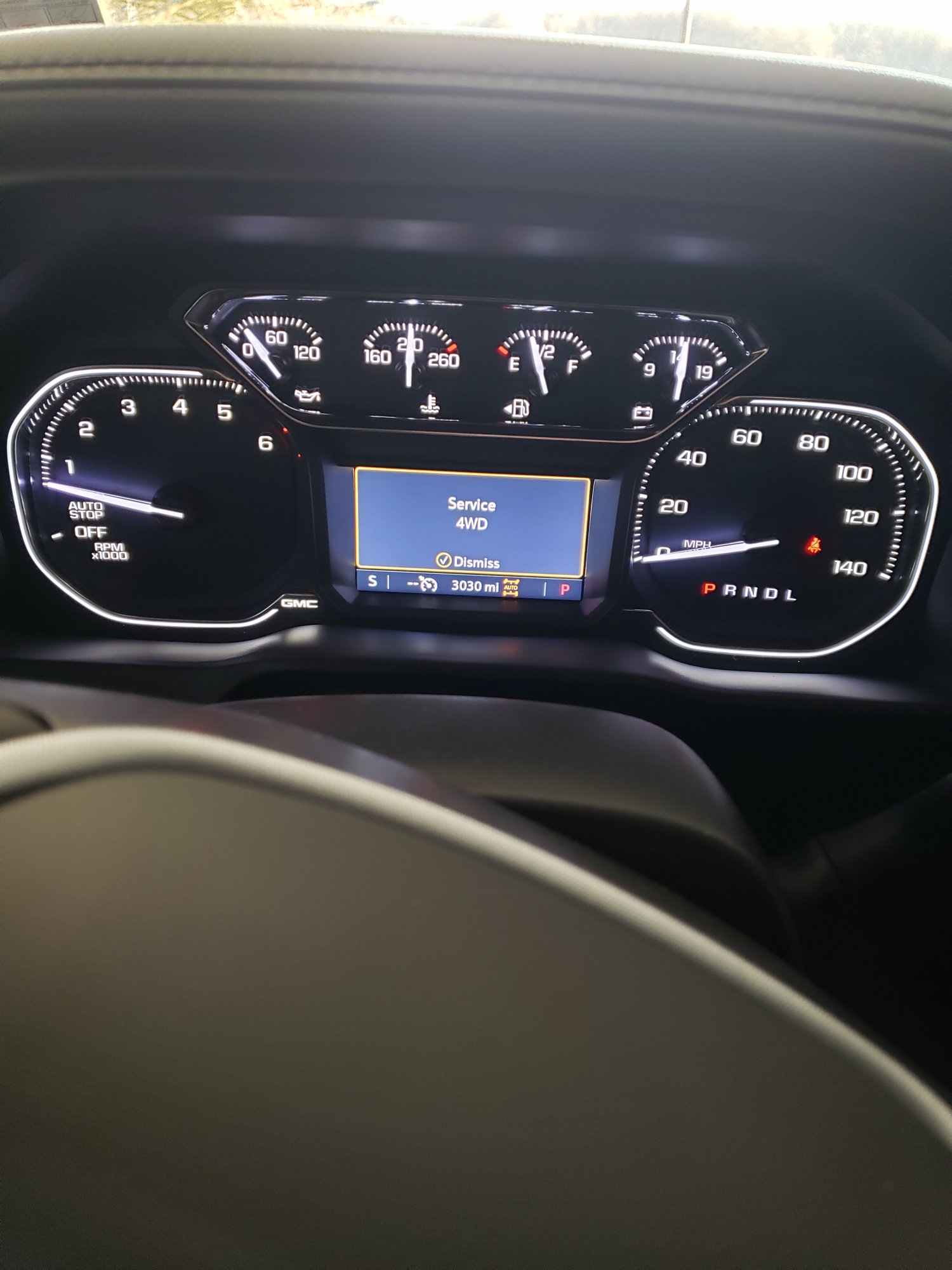

New owner of 2020 AT4(1 week old), and my service 4WD light came on last night on way home from work too.  I was in AUTO when I noticed it.  Was still on this AM.  I restarted truck and it wasn't there.
Dealer told me that it has to be on for them to see, but they didn't know the carbon bed was different than a regular bed....SERIOUSLY!!!

Light came on again when I pulled into my driveway. Hopefully the light stays on for the trip to the dealership tomorrow morning. Would have taken it right there but they said they dont have any loaners available or anyone to give me a ride to get a work truck.
