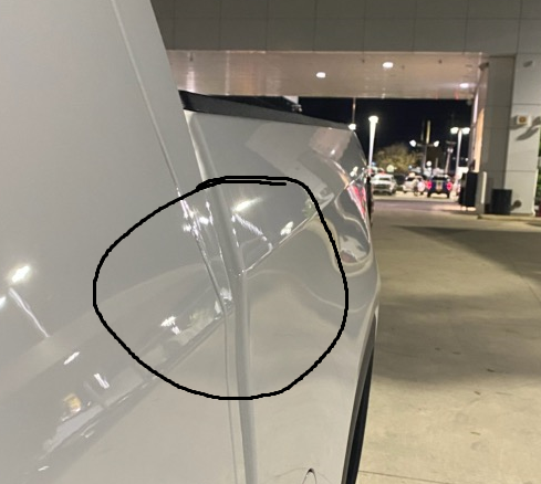

Had my 19 Silverado about three days before I realized... my bed sits about 1/2-3/4” further to the driver side than the passenger side.
I’d noticed I was getting crap fuel economy on the highway, something like 16.5-17 MPG. With a 5.3 i expected 20+.
The truck is now at the dealership and they are saying they have no idea how to correct this. They pulled 3 new trucks from the lot at random, they all were misaligned. No adjustment built in.
Anyone out there had this issue and GM gave them a way to fix it?

On the K2 trucks you can unbolt the bed with 8 bolts, might just need to loosen the bolts and slide the bed over? If nothing else they could elongate the mounting holes in the bed to allow adjustment... Not a factory suggested adjustment but, gotta live in the real world...

Tech at the dealer said they took out the adjustable parts.. so currently it is what it is. I’m hoping GM gives them a better option than cutting.

I wish I had taken a photo. My bed sticks out to the driver side, not necessarily further to the front or rear of the truck.
