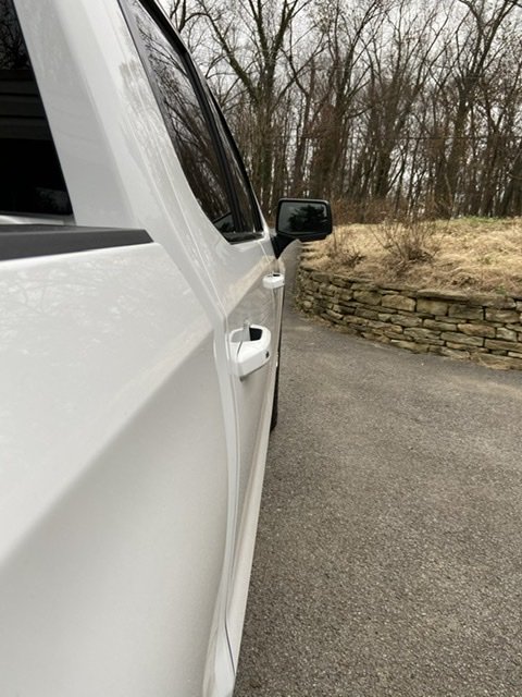

Did anyone get a fix from the dealership? I just checked my bed and I can stick my entire hand in between the cab and bed on the passenger side, Only half of my fingers on the driver side.
On 10/6/2019 at 9:00 PM, Chris101 said:
Same.  2019 LTZ, day 2 I’m driving on an open road, I glance in my driver side view mirror & thought the back door wasn’t shut because the body line was off.  So I pulled over to check, and it was shut.  This is when I realized it was misaligned. The body line has a 1” jog between the cab and bed on driver side. When I checked the passenger side, it’s aligned perfect.  Confusing how one side is aligned but the other is way off.  Returned it to the dealer who sent it to their body shop.  I told them to get me a new truck and that a $56k truck should not be seriously misaligned like this.  So looks like I’m losing my beautiful blue and getting a shadow gray instead.

It's not the bed...it's the cab.  The back, left corner of the bed needs to be shimmed up.  If you move the bed on one side to align, the other side is affected.
There is a member who successfully had his dealer fix this issue and it involves shimming/moving the cab, not so much the bed.
I'm ultra-OCD so this constantly annoys me but I'm not sure I want the dealer lifting my cab.  I'm sure that would affect other aspects of the truck.
