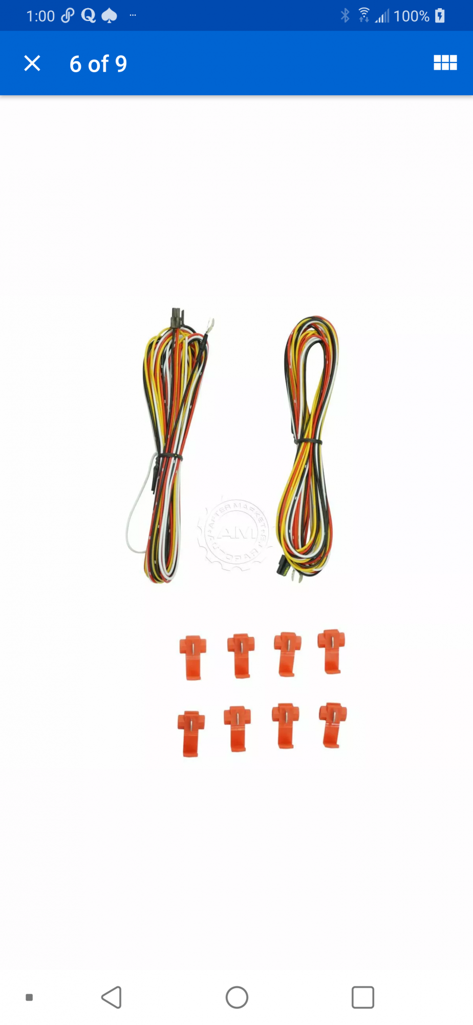

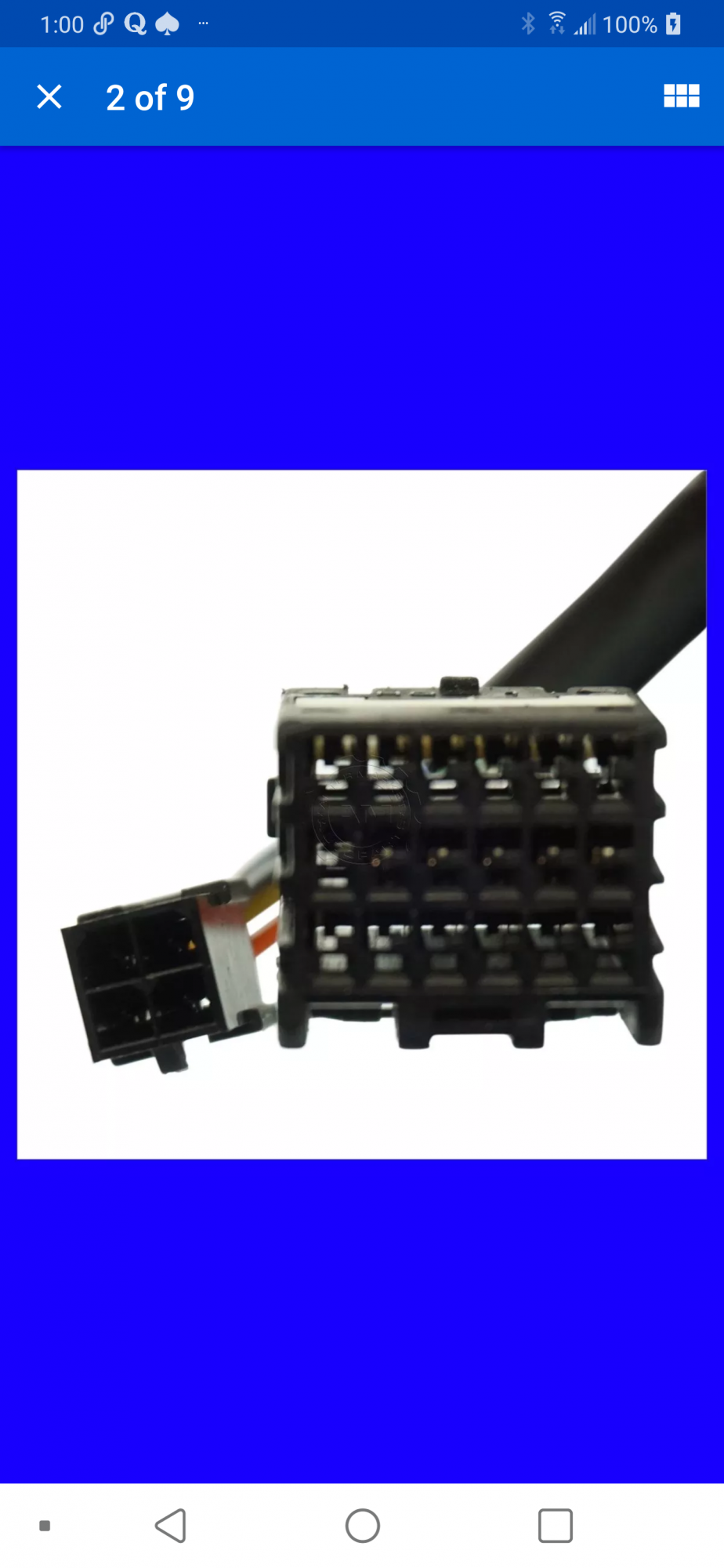

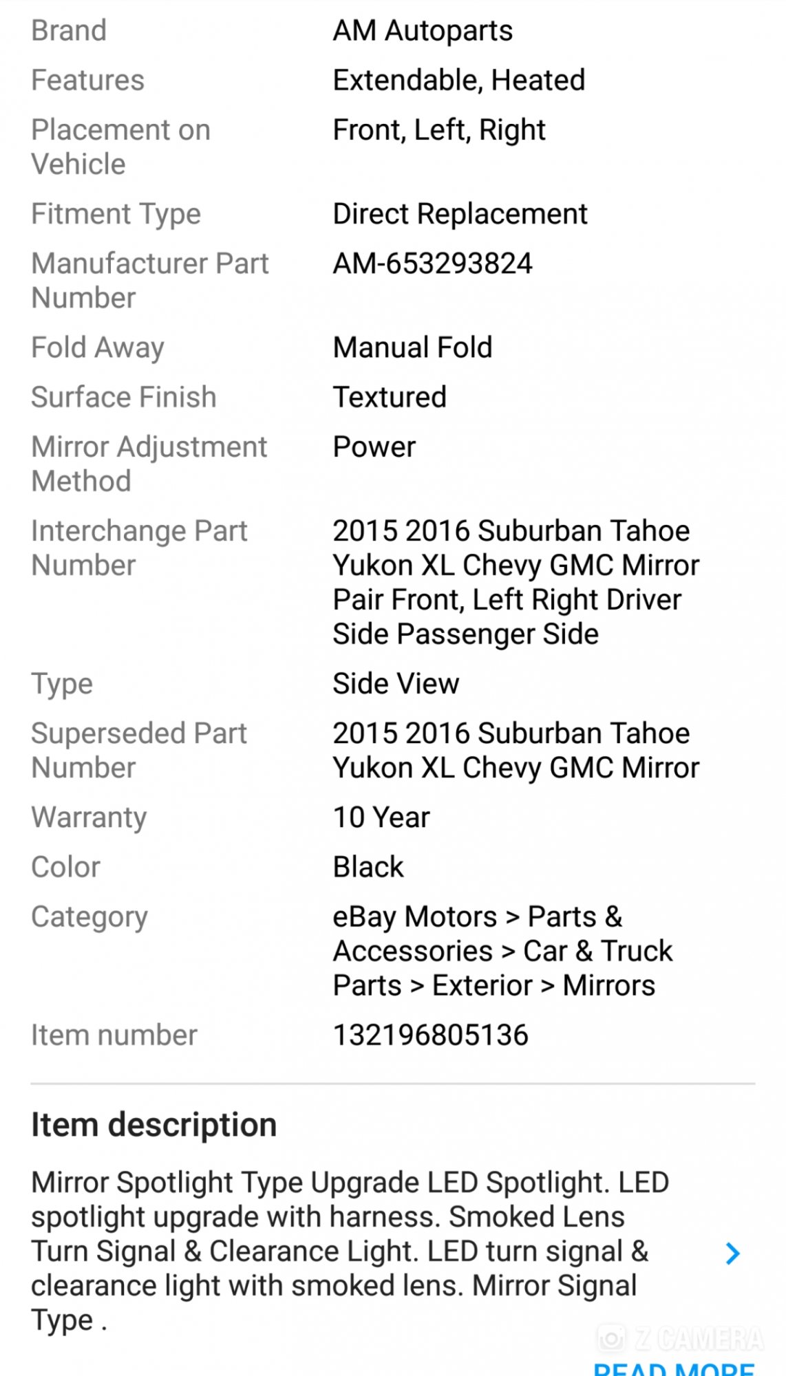

I bought two new aftermarket towing mirrors for my 2016 Suburban. Will the turn signals and LED back up lights work when they are installed? Those features were not available on the factory mirrors. The replacements have a factory plug.
Your thinking is correct. The running lamp and cargo light features won’t work as GM never offered tow mirrors on the K2XX platform SUVs.
I make a set of harnesses that will enable those functions.
Email me the brand & model tow mirrors you purchased along with some pics of the plugs and I can tell you what’s needed.

Thanks for the info. Here are a few pictures. I can take a better picture of the connector in the morning if needed. R/ Joe
Thanks for that info and pics. More pics of the large and small mirror connectors would be great.
