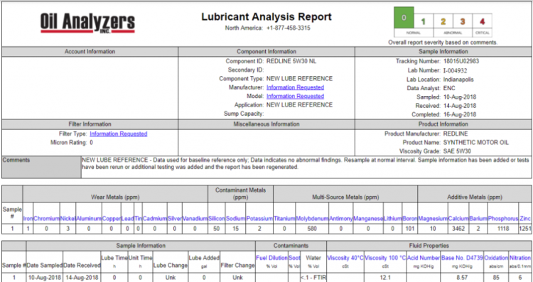

High enough to register 80 to 125 on oxidation.
Compare most recent AMSOIL SS VOA was 48 oxidation on a 5W30. 9/2020.
Red Line HP Euro 5W30 97 oxidation. 3/2023
Red Line HP Euro 5W40 82 oxidation, 12/2024 the lot I'm using right now.

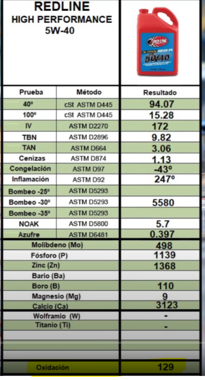

I was able to speak to one of Red Line's tech guys before they moved locations to TN.  I asked him directly that they advertise their oils as being ester based and some are questioning whether they use substantial POE.  He said some grades range from 20-40%.  The 40% is likely the 40 grade which has or had a virgin oxidation of 129.  So I would say Red Line's POE content likely ranges from 15-40% in some grades.  The guy that told me this can be trusted too.
To give you an idea, here is Red Line HP 5w40 (non Euro) with a virgin oxidation value of 129.  This is likely the one that contains the most POE if I had to guess.
