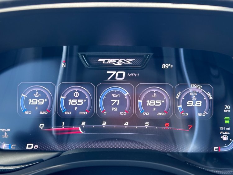

A tale of two TRXs.
Mine on mile 40 of a highway run in 90 deg heat. IMG_3931.thumb.jpeg.18a285ae2cd4d3ef67f266ee6e2f34d6.jpeg
Oil: 199 (Red Line 5w50 just installed)
Coolant: 185
ATF: 165

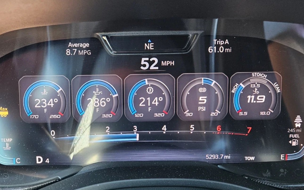

Meanwhile this is what most people think is OK:IMG_3933.thumb.jpeg.c2f7da326ce96472b7f502a41510fbf4.jpeg
ATF: 214
Coolant: 234
Oil: 286! (Factory approved 0w40, gotta save that warranty).
The fluid temps were well within allowed range. 286 may seem high but it was for a short period and is OK with fully synthetics. TRX has safety limits, which were beyond these temps.”
What’s the safety limit? Punching a rod through the oil pan to add extra ventilation? 😂
We’re getting beyond blind faith in the OEs and into pure ignorance at this point.
I heard an analogy somewhere that I liked. Imagine your body had a full warranty for 40 years. Would you smoke 3 packs a day and eat only McDonalds because all your medical expenses were covered for that time? Of course not because what happens on year 41? Vehicle warranty is no different. Factory spec oil is often the McDonalds, and those operating temperatures are the chain smoking.

Some observations there though.
The second dash.  Tow/Haul is on which IMO implies that truck was towing and is spinning 3000rpm where your truck was 70mph, I assume not towing and in 8th at under 2000rpm.
So two trucks in two different scenarios which would...have a sway in temperature readings.

Fair. But the point was more his nonchalant reaction (or really no reaction at all) to running those temperatures. It’s normalized, and even worse some people actually think it’s BETTER.
His truck still has the factory warranty using approved fluids, and stock thermostat & TBV. My truck doesn’t. Which one would you want to buy used?

Again as true as that is what it shows is the truck is not set up for towing. @OnTheReel 's dash would be what it should look like towing as well.
General comments to attached to the newdude quote:
Physics doesn't leave the room when it's towing or on track day. Thermostat doesn't do cooling, it does regulating. If the cooler is WAY to large for day in and day out task the thermostat keeps it warm enough. If the thermostat is defeated by a cooler to small then it needs enough cooler to put it in control.
When I first bought Pepper my dash looked like #2 on a hot day doing 55 mph. Not quite that bad but you get the idea. I took steps to get to the OneTheReel dash look and it does quite well up to over 90 F air temps. Even with all the modifications I would need more to tow or run the Mexican deserts.
GM gives us a 'starter kit' and a darn poor one at that.

I'm officially jealous. I can hit those numbers in that temperature, just not at 701 mph. I have work to do. 😉

Truck has a ton of cooling from factory. They just made poor decisions to use it. I’d be running 205-215 coolant, oil and ATF when stock in the same conditions.
I pulled the OEM trans TBV and found it’s the same part number used on V6 Challengers and Chargers which was an odd choice. 1/2” lines and a big cooler don’t mean squat when you’re necked down to 1/4” at the outlet of the TBV. A TBV that is set to open way too late as well.IMG_3957.thumb.jpeg.1c2b3cc95bab48725a88a039cabad444.jpeg
