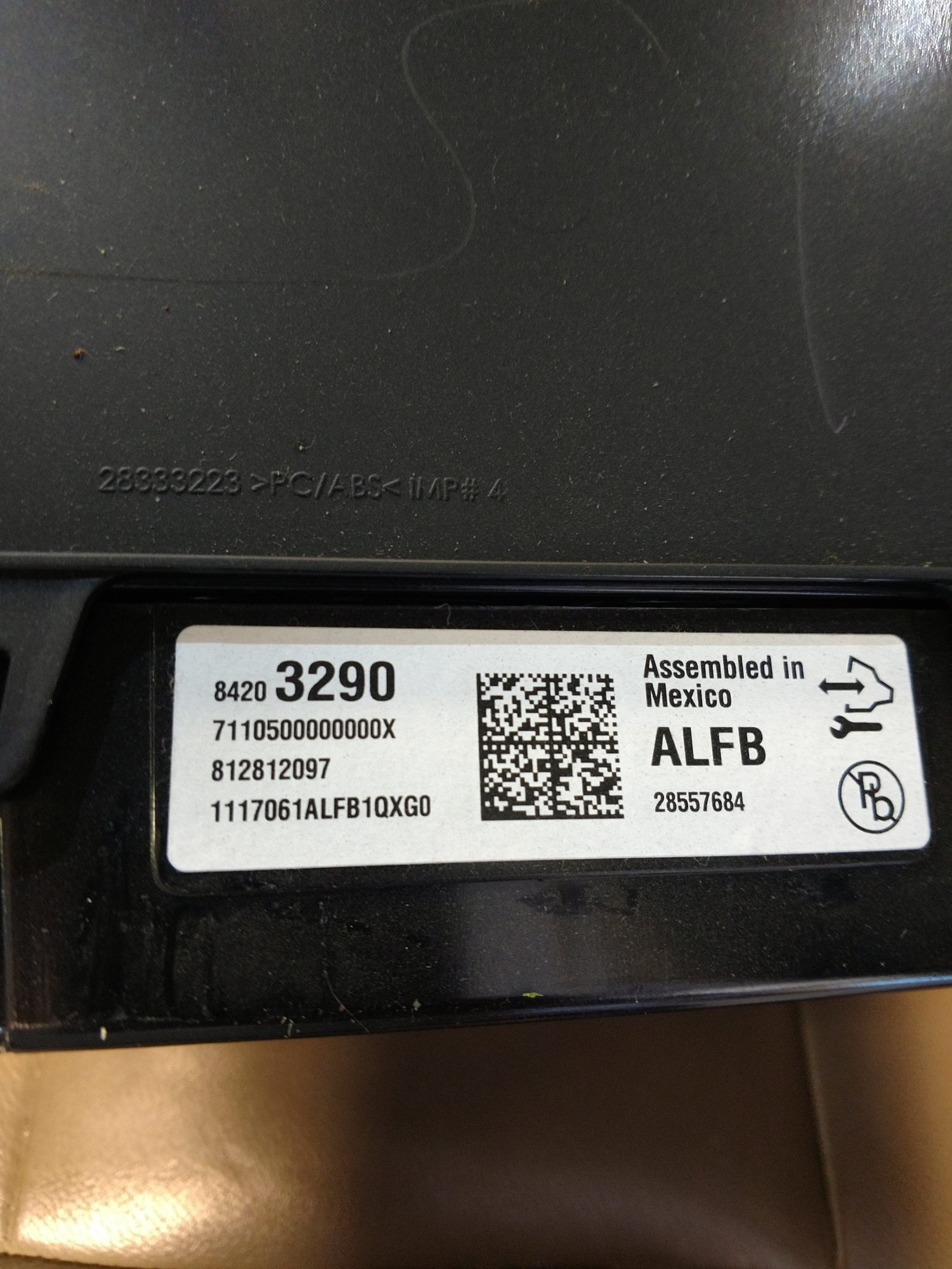

So I tore apart the dash and removed the instrument cluster, took the covers off and reseated what looks like the ribbon cable for the DIC. Its working for now. Not sure if this is long term or if it'll keep working. If anyone else has had this issue I would be curious of the outcome. I have attached pics of it disassembled if it helps anyone. The good thing is, it was easy to take apart to where I had it. The next step would be to remove the LCD and see if there is a part number on it and if it could be easily replaced. But I don't want to take the LCD out until I know its totally not working in case I wreck it when taking it out.
