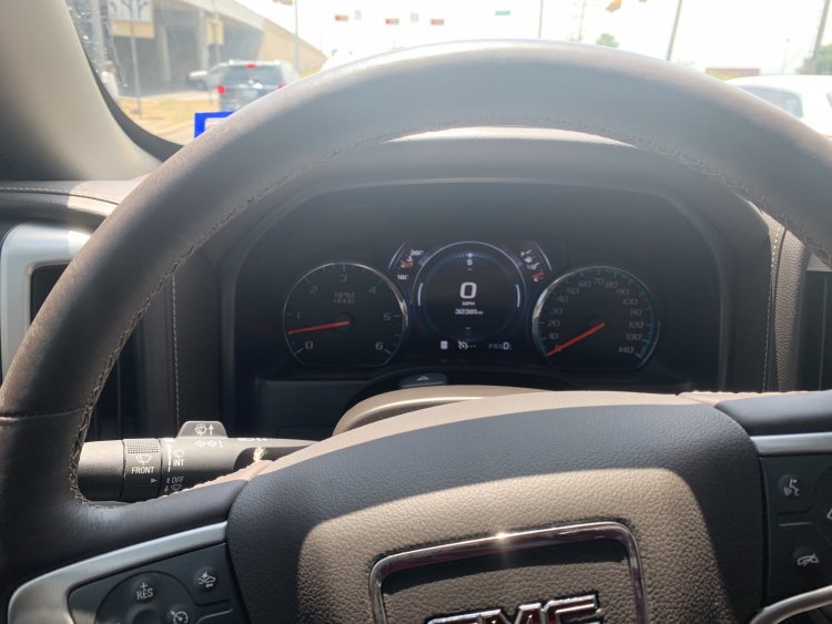

As I'm sure many other readers of this forum have done, I found myself going through some of the posts and checking out some cool things people here have done to their trucks. I happened to stumble on the Denali Cluster retrofit and from the moment I saw it, I had not stopped thinking about doing it. Being someone who opted for a non Denali truck but still paid a pretty penny, there was always a small itch in the back of my mind at the lack of a couple features that these trucks have compared to other lower priced vehicles with less prowess - the instrument cluster being so plain is one of them.
After eventually deciding to scratch that itch, I got in touch with Chris from White Auto Media (WAMS | http://www.whiteautoandmedia.com) about the Denali Cluster retrofit. Now, there are several posts with a wealth of information about this (main one attached below) and if you are interested in doing this modification, I highly recommend you start there and understand everything there is about selecting the right cluster for your vehicles model year.
After exchanging a few emails with Chris, he noted that I was able to have him source the cluster for me and take care of the programming. At the time, I was unable to locate the correct fitment of cluster for my vehicle and the sellers on eBay just seemed to be too sketchy, some had cracked plastic lens covers, and others just didn't provide enough information for the amount of money they were asking for. As a result, I went ahead and submitted my details to Chris via his website and ordered the cluster. It did take two weeks plus a handful of days for sourcing the cluster, programming it, and shipping it to my doorstep. Not only did Chris make it incredibly easy to do this modification, his kindness in sharing information about the entire process to ensure that I had the right fitment, right cluster, right programming, made this experience all the better.
Once I got my hands on it, I was able to get it installed in my vehicle in about 10 minutes given the right driver to take out some 7mm bolts and a little bit of prying with my fingers. In the end, I have a fully functioning, slick looking, Denali Cluster.
Install video: Phil Gamboa did a fantastic job documenting the install and how easy it was. My only deviation from the video instructions was not taking off the bottom panel where the hood release latch is located and I was safely able to install the cluster without breaking or scratching any components in the process. Link: https://www.youtube.com/watch?v=HLq-VVcEL8I
I attached a photo of my working dash to the post! I'm glad to have went this route and hopefully, I will find a way to give Chris my business again in the future!
