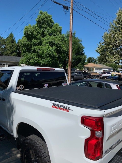

I installed the BAK Rev X4 on my 19. It was an easy install by myself in about less than an hour. Alignment took the longest but it all closes flush and easy. The weather stripping on the rails at first was all wrinkled but after being in the sun a few days it all smoothed out and now sits flush, haven't had any leaks or anything on it. The matte textured vinyl like finish on it looks great next to the black plastics on the bed caps and with some UV protection shine on them all it really looks good against the white truck. I know some of you have had some complaints with the BAK but mine went on easy, looks great and functions as advertised. When rolled up I can still see out of the rear view mirror so that's not and issue and one of the reasons I stayed away from a tri fold style cover as well. The tail gate opens with the key fob button just fine as well.
Now there are two things I done like about it. First the front seal by the cab is very thick, which is not an issue, but it sort of makes the cover bow across it with the middle part of the cover slightly being higher than where it attaches at the corners. It doesn't leak or anything through there but I would like for it to just be flat all the way across. I believe I cam up with a solution for that but I'm currently deployed so I'll see if thee parts I ordered can correct that when I get home.
Second, I think I caused part of this issue, is that I have to pull the cord that contracts the locking latch so that I can close the cover. I'd rather be able to just push it down and have it clip into the latch. However I did accidently bent one of the rails latching mechanism's when I was installing it so I suspect this if my fault and won't put the blame on BAK for that reason.
Other thank those two things, I'm extremely happy with the product over all
