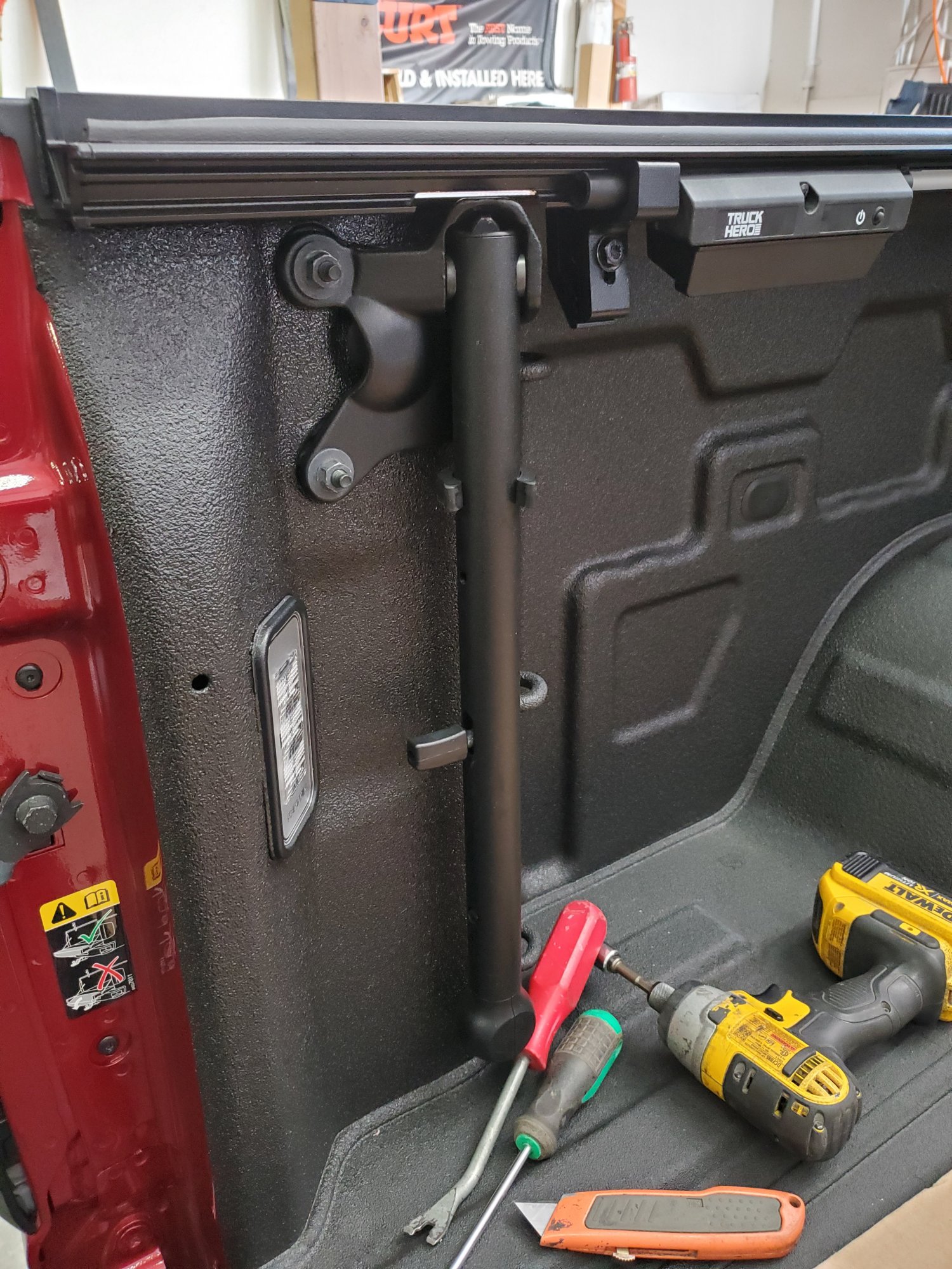

Just went over the install and there was an adjustment needed for the handle. The cover came with a bracket meant to mount in the corner where the handle is currently installed. The handle is supposed to be removed and the bracket installed then the handle mounts back on top of the bracket. The problem is that the bolts are factory mounted inside the bed and aren't long enough to reuse like this. So we installed the bracket further back in on the rail just behind the handle. The bracket meant for the handle is also not painted whereas the ones that mount on the rail are so they sprayed it for me. I'm guessing that because it was meant to sit behind the handle it wasn't meant to be seen. I'll post a pic shortly.

Here is a picture of the install. All 4 guides are now installed on the rails as opposed to the instructions showing to install the one on the handle mount. Works great and locks perfectly.

I've watched several install videos for 2019 GM trucks - none had the assist handle which figures?  I may be able to slide the included light onto the rail first and not have to take off the assist handle at all.  That I can think of, that should be the only thing which would get in the way of the assist handle based on the install videos that I watched.  The clamp in that area can be installed without removing the handle as well.
I'll get it figured out - thanks for the additional info & especially the pic!

Got the Ultra Flex installed this evening. Didn’t have to remove the assist handle since I slid the LED light bar on the rail first like I mentioned earlier. Ended up looking almost exactly like your pic as far as bracket & light bar locations. Pretty pleased with it but will have to see how the weather strips behave after a couple of weeks in the sun. Will double check alignment as well - got it close enough for now.
Thanks again for the info & pic - made things much simpler once my dumb a$$ figured out exactly where the brackets fit into the rail. A bird crapped on it not 2 hours after I was done ?

Glad it worked out, That's what these forums are for. Looks great btw.
