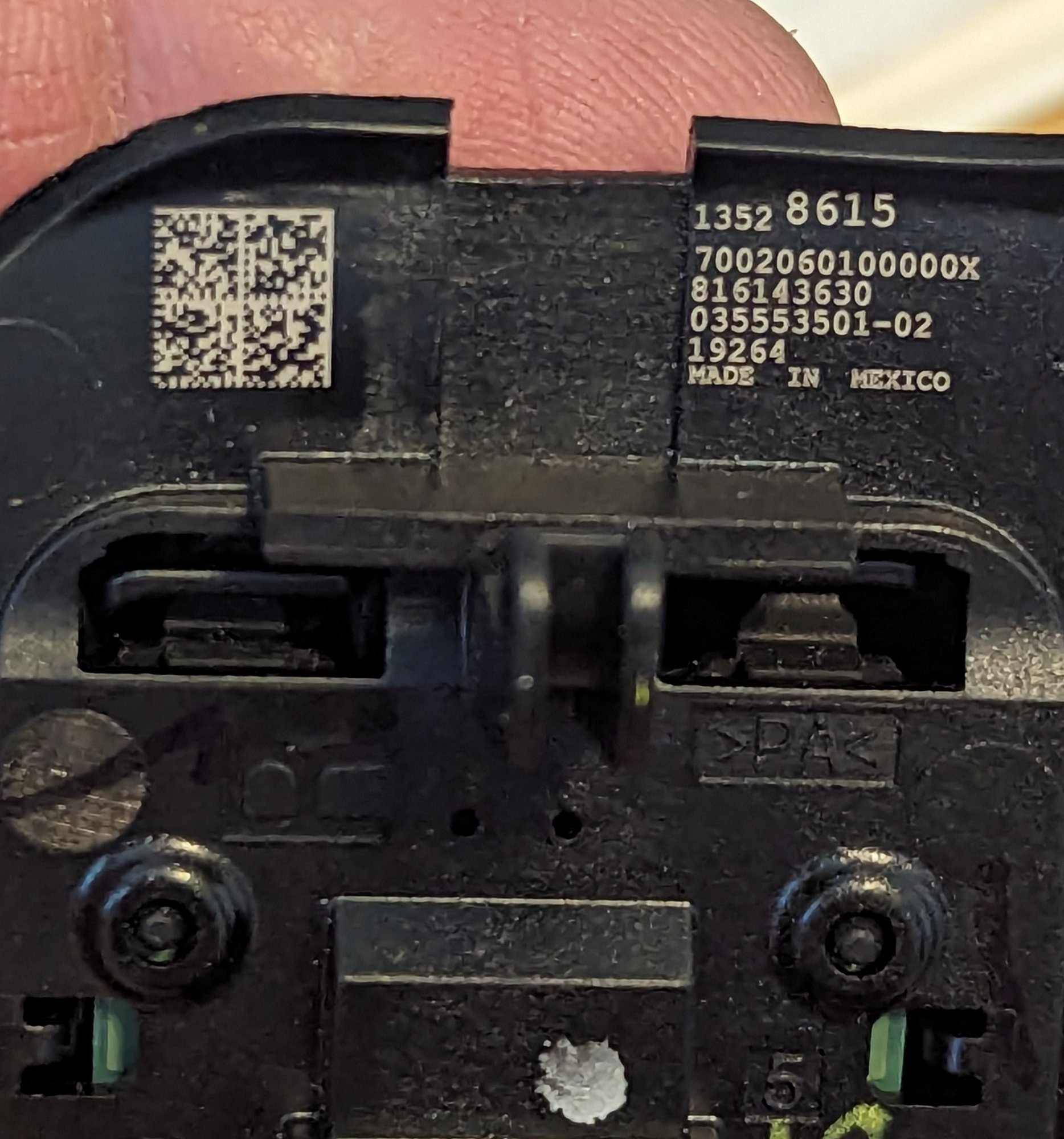

same problem today.  I took the switch out and looks like part number is 13528615
this is off of a 2020 GMC sierra AT4 with all the goodies, tech pkg etc...
the bottom of the steering column has a single 7mm bolt coming up from the bottom, and two facing the driver, you have to turn the wheel to expose the side bolts and remove bottom of steering wheel column, with a few locking tabs.
Remove two little panels, one on each side of the front part of steering wheel away from driver.  This exposes 2 bolts torx T-20 on each side (total 4) that go through the actual switch housing, remove those.
Remove 4 torx T-15 bolts from the steering wheel front cover(away from driver).
this should allow the steering wheel cover to move enough to get the switch out.  you have to disconnect the wire connector first, that's the hardest part, tiny little connector, the clear part slides out, away from switch, then push down on top of connecter while pulling apart.
PXL_20230205_213940544.thumb.jpg.6283cc2c9594d2f3d22e725d8e4d444e.jpgPXL_20230205_213640261.thumb.jpg.5dc183e56083ef68fcad0b1a5aef6f21.jpgPXL_20230205_213925170.thumb.jpg.1e6974519e045a051cbf40f65cb6b37a.jpg
Edited by MG386
disassembly instructions
I called the dealer to get a new switch and the part number has been changed/updated to 13540148 as stated in a previous post.
