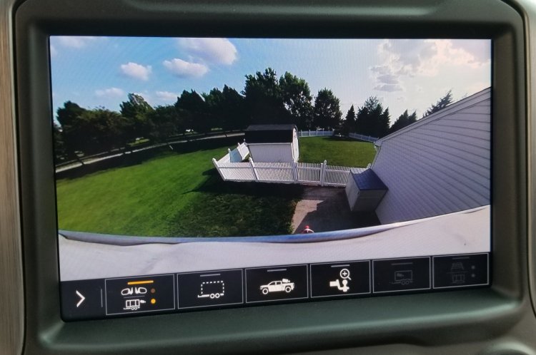

I got my camera in the mail today. Wasnt 100% it was the right one but turns out it was.
I was concerned becuase the plug on the truck is keyed different for inside and outside the trailer. I found the plug on the camera is keyed for both depending on how you turn it.
I did not measure the cable length but I have a Work and Play 25 WAB which is about 30ft total length. Id guess the cable length at 40-45 ft. Plenty for my set up but a 35+ ft unit might have to get creative on the routing.
