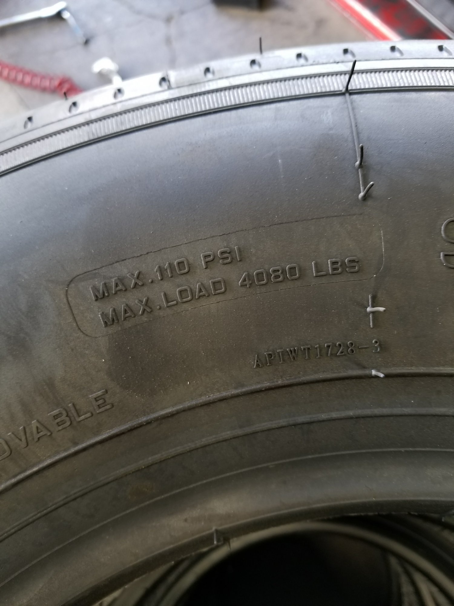

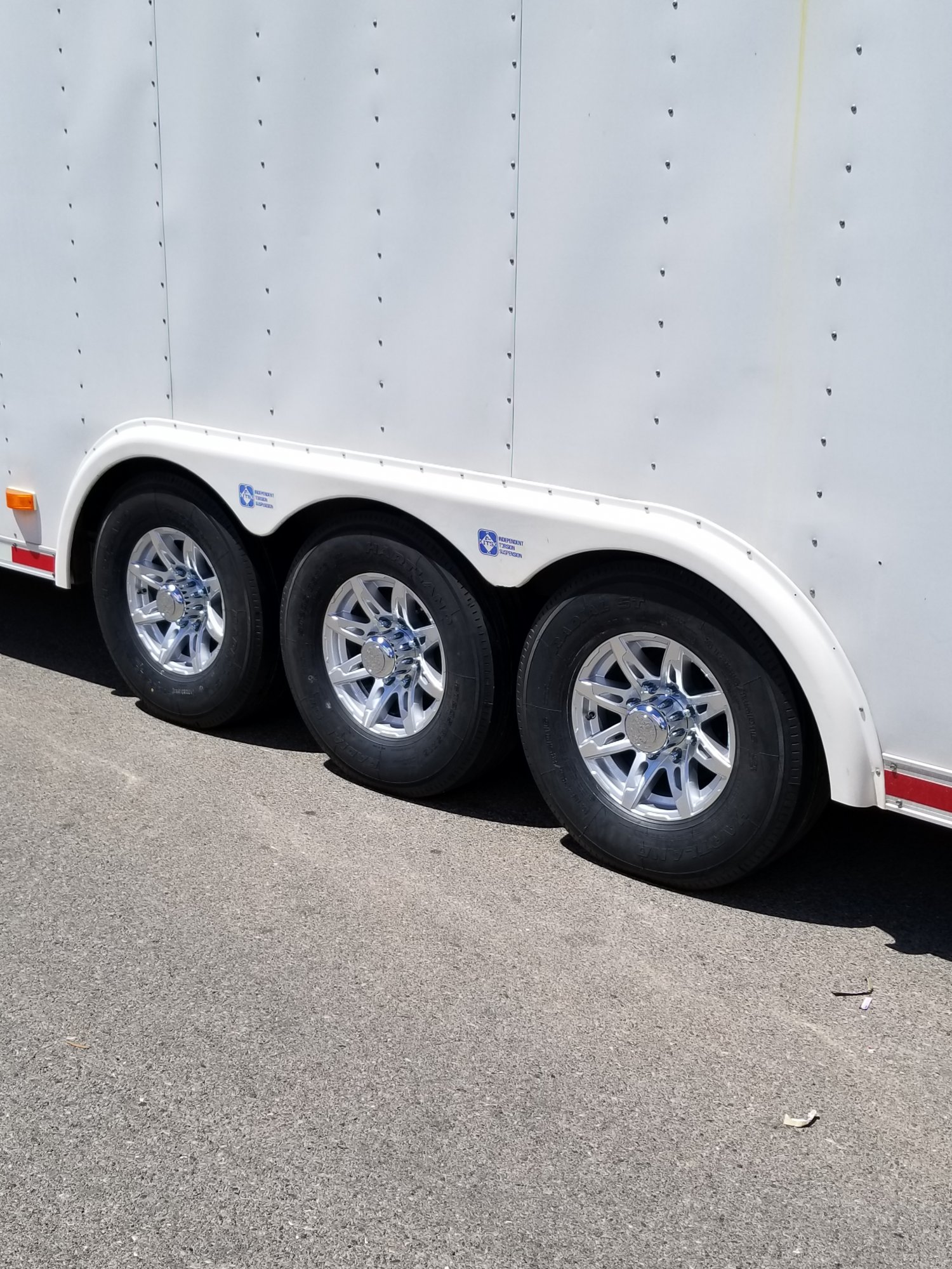

Roadrunner I totally agree. Yet some times GM has let us down. I have a trailer that has 6 tires and they are "G Rated" tires. It runs at 110 PSI. I also understand a lot of ranch show horse / cattle trailers are encouraged to run G rated tires AND rims. You can see my tires / rims rated at 110 PSI. I was planning on a new Denali crew cab with a 8 foot bed and fully loaded. But it appears with the labor dispute and the intentional delayed sloooow  Christmas release. Well since it will be so close to the '21 model I may just wait it out. New interior OR old style. See what price breaks will occur.
Chuck

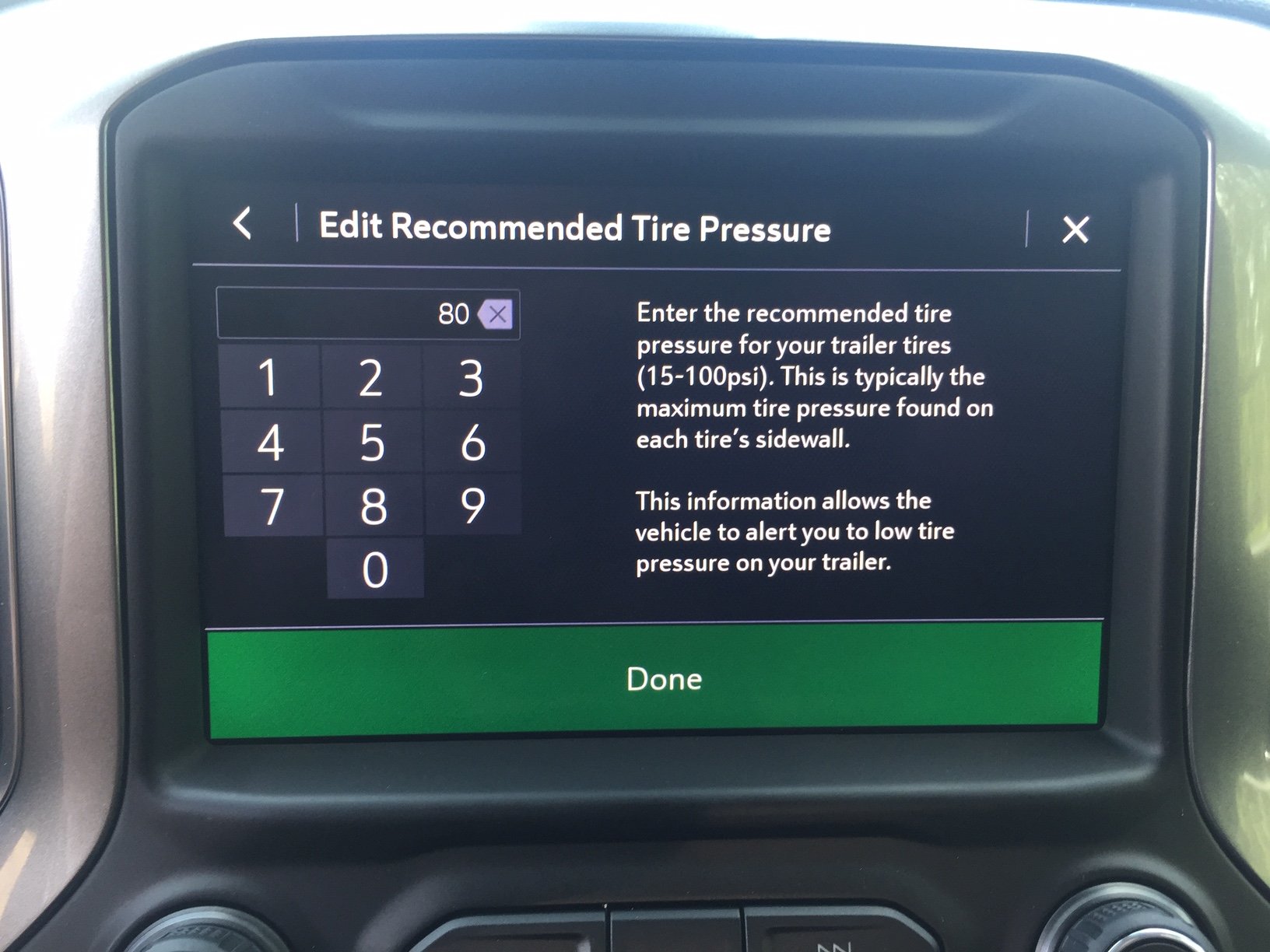

i set my ttpms sensors up a few nites back but couldn't remember what the max psi choice was and didn't know if they could be edited with out a new set up. they can be edited once set up and the max psi setting looks like a 100psi. mine are set for 80psi with E-rated tires
1 hour ago, BB&Chiveon said:
i couldnt figure out how to edit - what steps? thanks

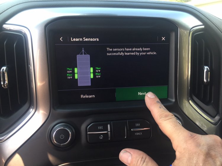

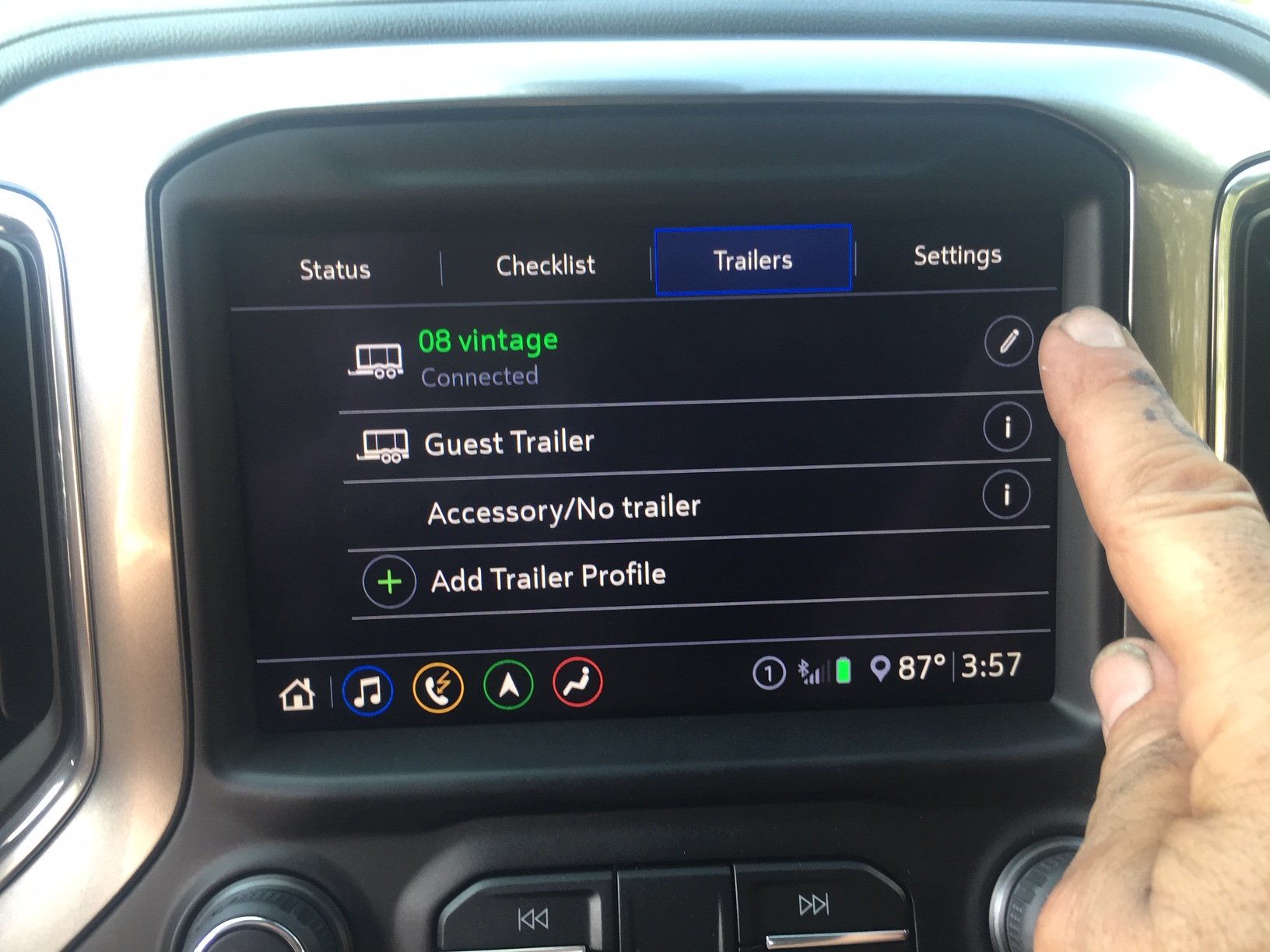

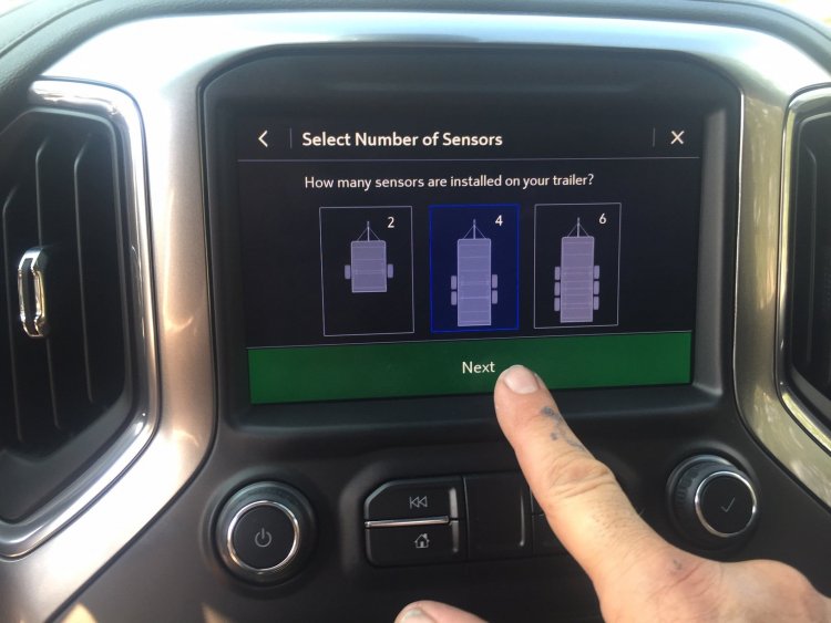

first connect the trailer so you can access the app.
pick the"trailers" tab on the top of the screen
push on the pencil next to the connected trailer on the screen.(pic 1)
pick "tire pressure set up" on next screen (pic 2)
pick "next" on the "select number of sensors screen" (pic 3)
pick "next" on "learn sensor screen" (pic 4)
the next screen is where you can edit tire pressures(pic 5)
Chuck
I am guessing that since your tires are dismounted you upgraded to a more reliable tire before some adverse happened.  Yes the labor dispute has me wondering how long a delivery delay will occur. I placed the order towards the end of August and the dealer said the tentative build date was the middle of October. Allot of variables exist do to the strike. Good luck on our future purchase I agree the interior is a bit dated compared to other manufactures. I can deal with that just hoping it lives up to my expectations performance wise when I hook up to my fifth wheel.
Well it appears as if GM has created a truck capable of hauling best in class payloads but didn't take into account trailers that carry those types of loads have tires that exceed 100 PSI, quite disappointing to say the least. 100 PSI is close to my tire rating of my trailer tires but 10 psi lost pressure on a hot day could be enough to cause a blow-out which is the whole point of the TPMS system. Perhaps with enough customer complaints they might push thru a software update to correct this shortcoming.  Thanks Jack for taking the time to answer our concerns.
