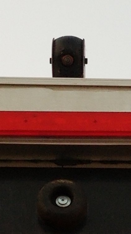

15 minutes ago, sdelam said:
Good info, Thanks. The trailer calibration thing is a pain right now. I have the camera mounted on the roof of the toy hauler angled down at the max limit per the instructions due to the size on the ramp door. Less of an angle would leave larger blind spot directly behind trailer.
Transparent trailer won't calibrate will the camera in that location.  The trailer camera needs to be in center of trailer 4 inches higher from the ground than the camera in your tailgate with trailer attached.  The camera needs to be at an angle of 35 degrees.  Point the camera directly down to the ground and tilt it up to 35 degrees.
I realize with toy haulers and trailers with drop gates this creates a problem.  You could potentially smash the camera on the ground.  You may not be able to use transparent trailer with these trailers.

Did not see that in the instructions that came with the camera or the owners owner's manual. That would be good info to have before I drilled holes in my camper. I did consider placing it in the center of the door, there probably is enough ground clearance for the camera but the instruction specifically say not to route the cable under the camper.
It did calibrate eventually, just took about a mile of less than 30 mph. But lost the cal during fuel stops. I thought perhaps it was due to me not allowing the system to fully boot up before pulling away from the pump.

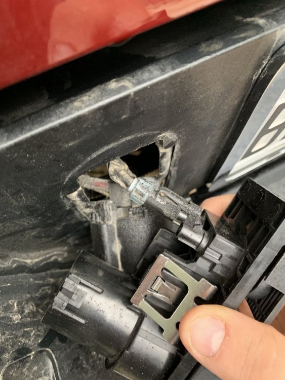

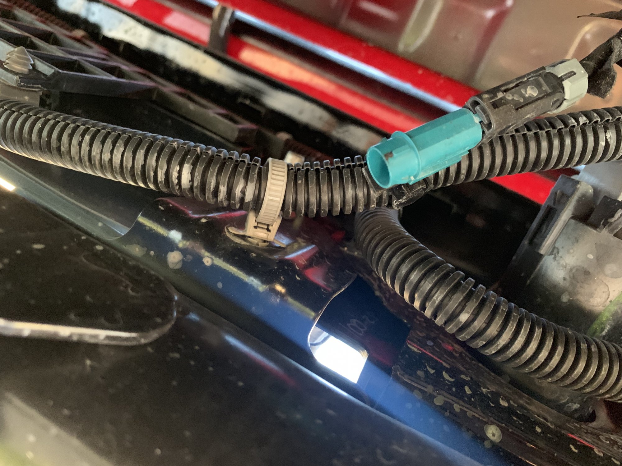

Only reason I ask is because it appears that the camera coax cable is actually taped under the bumper, at least on my truck. I ordered the trailer receptacle with the camera ports and that cable plugged right in. Nothing appeared on the infotainment, as expected but I haven’t tried plugging the camera in yet since it’s so expensive... maybe the dealer has to program something?

20 minutes ago, 2k19Sierra said:
I'm not sure.  I know you must have a trailer information module.  This shows up as the trailer app on your infotainment screen.  Option code U1D.
Yea exactly. I might have the dealer have a look at it next week when I get my first oil change. See if they can program/activate something to make it work. Been scouring the wiring diagrams to see what i could be missing. I even have the trailer camera module fuse installed! Can’t be difficult to get camera to work.  Maybe I need one of these video modules installed...?
