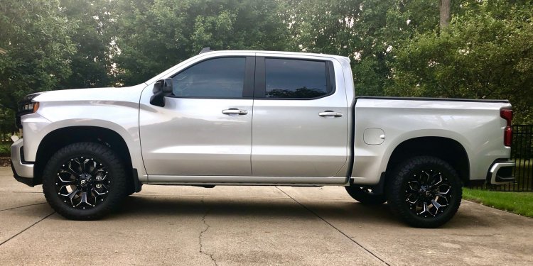

jkrunningdeer Posted July 18, 2019 Share Posted July 18, 2019 I'm installing a 1" motofab level front and back on my 2019 RST crew cab silverado and wanted to change my tires out as well. Does anyone know if 275-65-20 nitto ridge grapplers will fit without rubbing or trimming? Thanks! Quote Link to comment Share on other sites More sharing options...

Ezekiel2517 Posted September 24, 2019 Share Posted September 24, 2019 (edited) I suspect they should. These are 34" tires but not that wide. 275/60r20s fit stock with lots of room to spare. You would be adding an inch of height but only half inch of sidewall. Just go with 2" then they will definitely fit. There is a guy who posted about 295/60r20s (34" but wider) with a 2" level and they look great. Edited September 24, 2019 by Ezekiel2517 Quote Link to comment Share on other sites More sharing options...
runningdeer Posted September 25, 2019 Share Posted September 25, 2019 5 hours ago, Matthew Steger said: Did you ever figure anything about this? I am looking at tires as well. Ive got the same tires as you currently and looking for something a little more beefy. I went with the stock 275-60-20. Nitro ridge grapplers. No issues. The 65 would have fit. Quote Link to comment Share on other sites More sharing options...

AgDoctor Posted September 29, 2019 Share Posted September 29, 2019 I went with the stock 275-60-20. Nitro ridge grapplers. No issues. The 65 would have fit. Did you go with the LT or non LT version?Sent via Morse code Quote Link to comment Share on other sites More sharing options...
AD80 Posted September 29, 2019 Share Posted September 29, 2019 I have a 19 Sierra slt, (non at4 ) and I drove my 275/65 ridge grapplers home from the tire place on stock suspension, and put ready lift 2” the next day. Believe it or not,I don’t think they rubbed with the stock sus. Now I didn’t get out and turn the wheels and check the clearance and all that stuff because I knew I was gonna put the level on anyway, but I never heard them rub while I was turning. Maybe they would have if hitting a hard bump at full turn,I don’t know. Quote Link to comment Share on other sites More sharing options...
