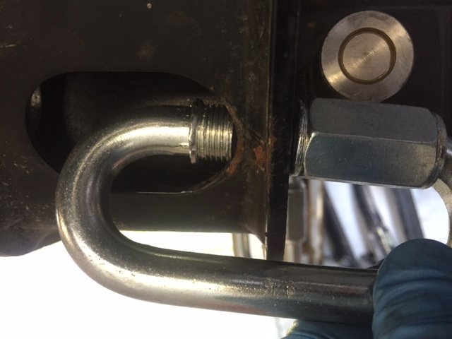

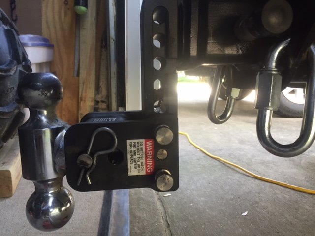

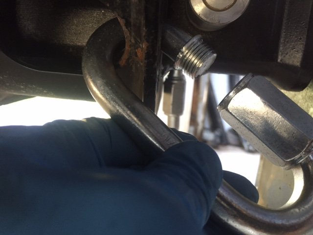

Here's a pic of the quick links I use until I replace the narrow hooks with new clevis hooks.5b41c5294fde29da2cf4c45faea0d805.jpg
Sent from the demons in my head
I used 1/2 clevis.  Lot stronger than quick links.
Agreed. The quick links were a temp solution until I find clevis hooks NOT made in China.

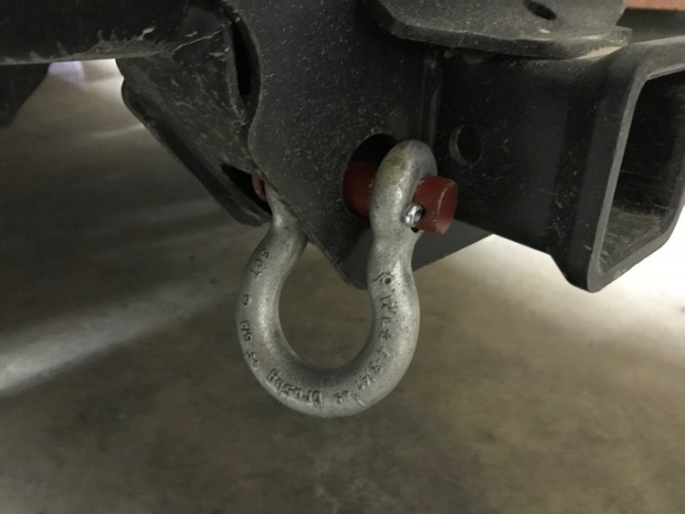

There are a few different ways to solve that problem, I put these on in 2015 and still work fine on all my trailer hooks.
I used these and really like them.   Crosby 1018133 with 4.75 ton working limit and  3/4" pins.
