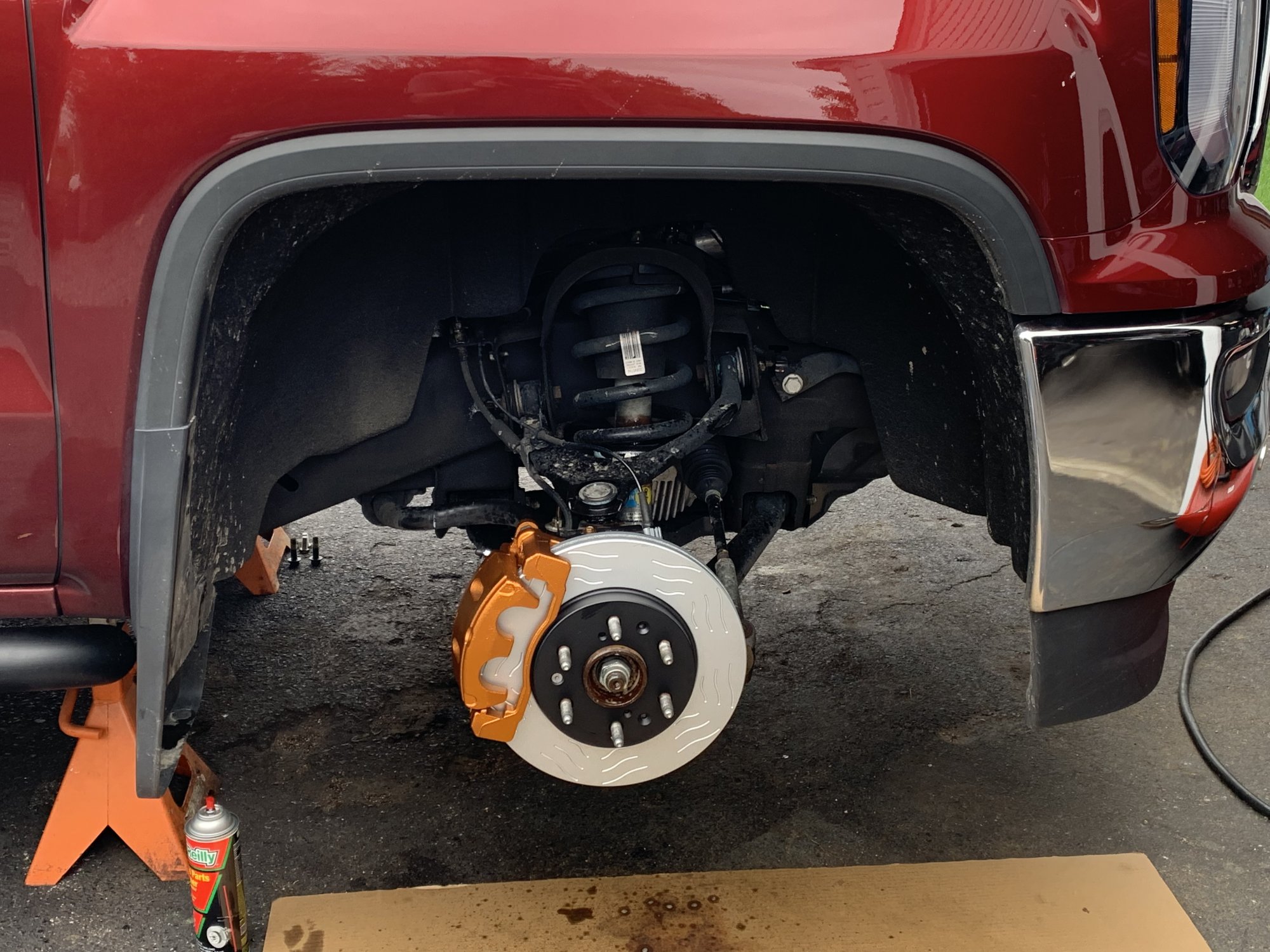

Posted in another thread...but to follow up
2017 Sierra. 63 k
front pads 50 percent worn
front rotors are warped. Pads dug into them pretty good.
All slide pins were fine.
Everything came apart easy minus the bleeders. They were starting to rust jack and didn’t come out well. Bought a new set from NAPA...the self bleeders.
Removed calipers to clean and paint them. Trying to keep the rust away and make this thing last.
waiting on pads delivery (Friday) but went with AC deco severe duty from RA. Came to a little under $300 for the fronts.
Rears at a later date. Not sure if they need it but I plan on pulling the calipers to paint and match the front sooner than later. I’m 99 percent sure the front rotors were causing the pulsation at highway speeds while braking.

So I went to check out the rears. They’re smoked.  Brake shoes shot too and crumbled coming off.  Had to beat one rotor off. Wicked rust holding the rotor from passing the shoes. They were at the lowest setting too.
Its a shame the rear calipers aren’t painted. Corrosion like crazy. Hardware clips were flimsy too.
Ordered the same ac severe duty rotors and pads. Love the fronts so far. Cleaned up and painted calipers too.
It seems that once you need rear brakes, you might as well do calipers and brackets too. Same with parking brake shoes.
