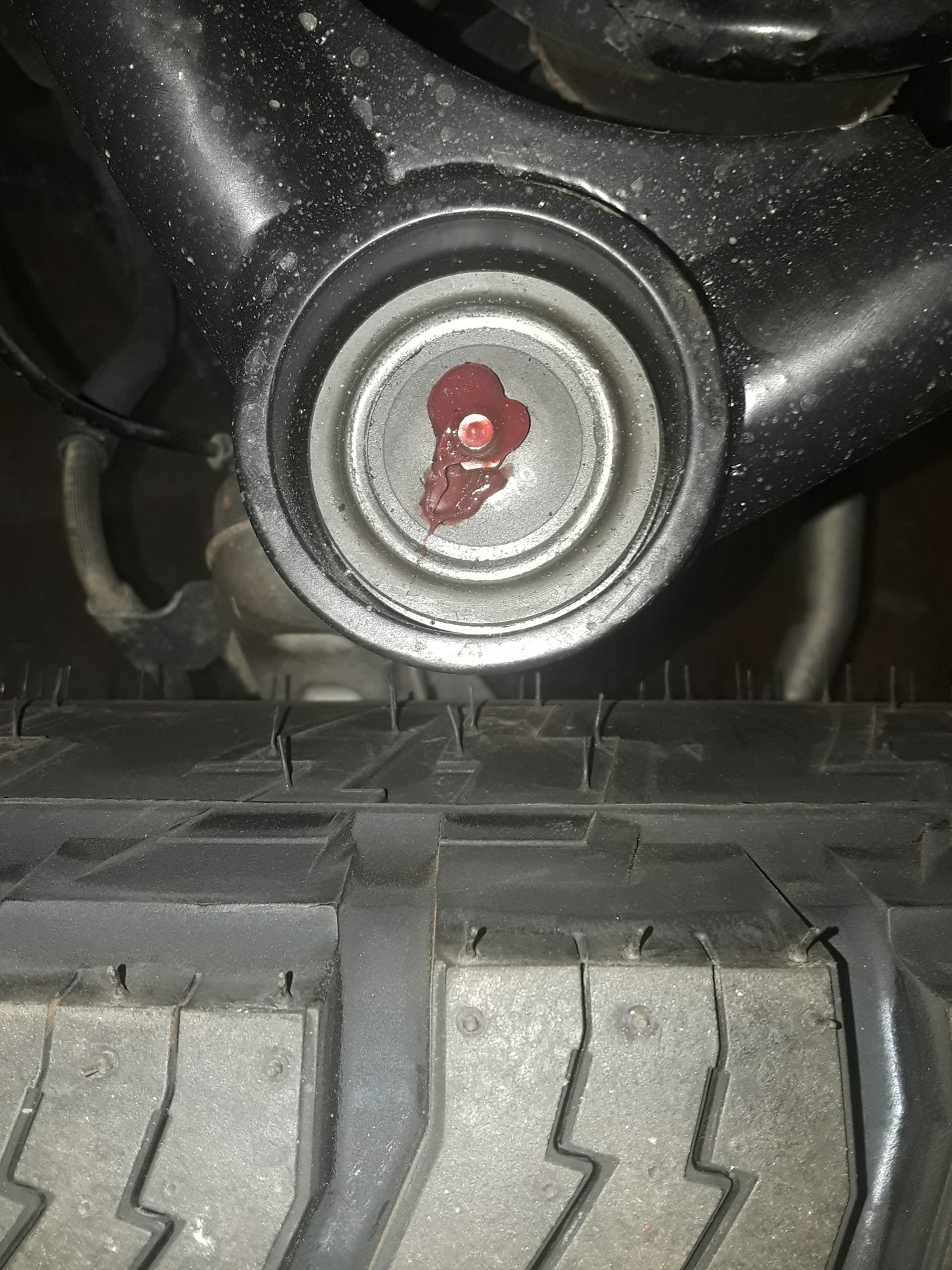

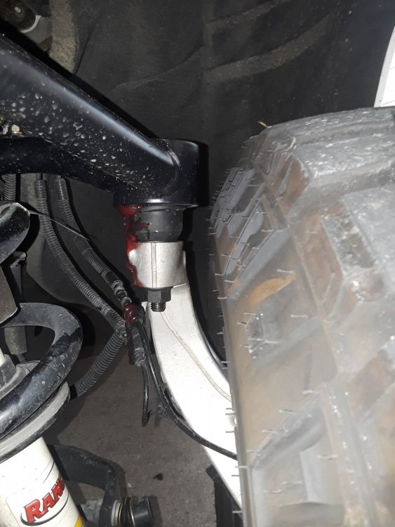

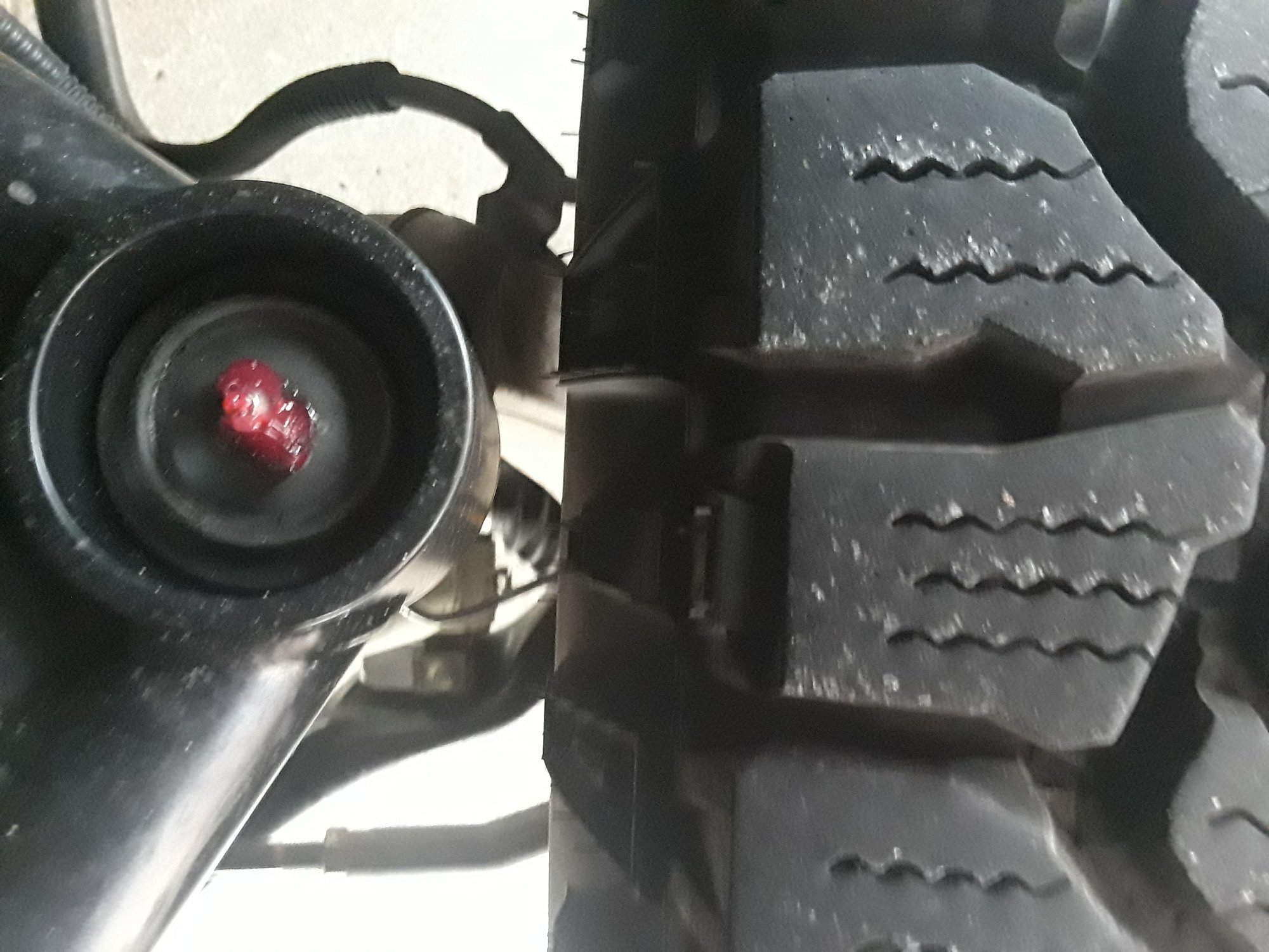

I had the kit installed today and everything looks good. Not much room between the upper arm cup and tire. Going to see what tires will fit tomorrow.

I went and tried a nitto 295/70r18 on stock wheels. It cleared but there was very little room between the cup and the tire. I ordered 285/75r18 wildpeaks.

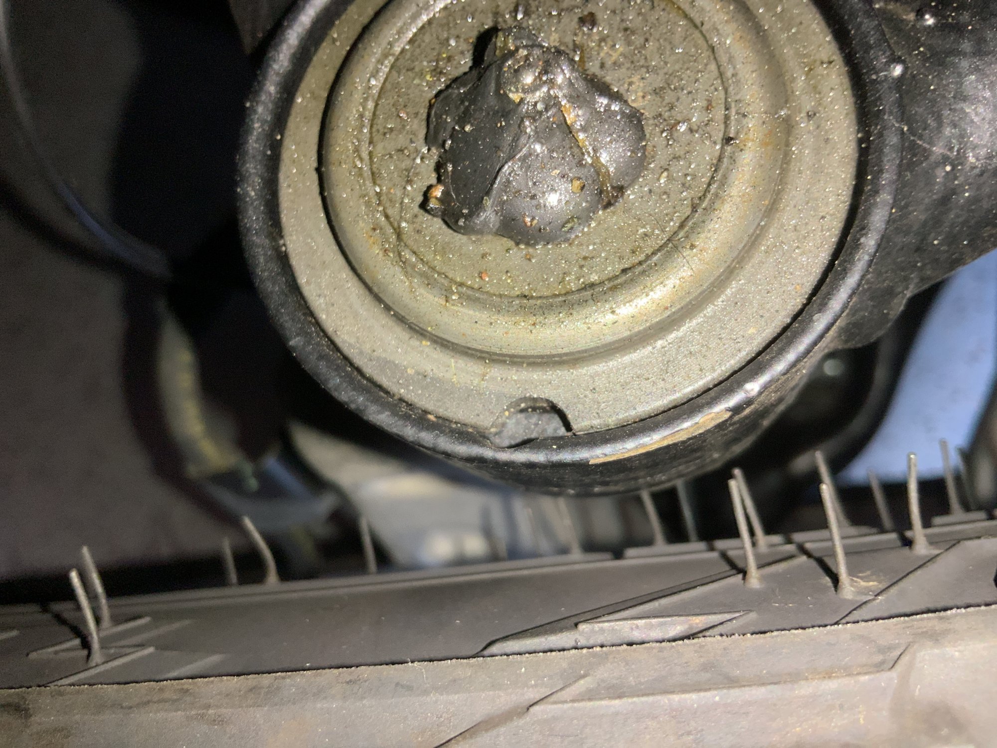

I ran with this little clearance for  8 months, no issue
What upper arm is that? What tire and size
Well the upper control arm is Rough Country but the OEM UCA was the same distance, The tires in the picture were 305/45R22’s
What was your offset? Mine is 24mm on the stock wheels witch puts the wheel in more towards the frame
I have no idea, they are OEM 22” High Country Wheels
