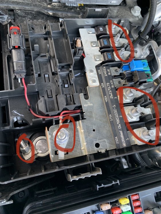

Good news. Let us know how it goes. I haven't had a single issue since the dealer tightened the bolts on my fuse box. It's been the champ truck I had hoped for... Gaining confidence back a day at a time.
