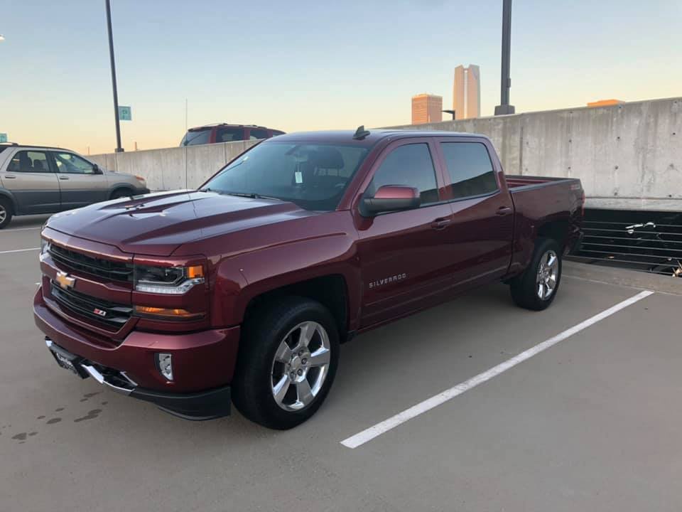

Morning Everyone! New to the Silverado and Truck game. Have had sports cars my whole life (I’m 44) but needed to get into something more practical and room for family. (Don’t hate, last 4 cars have been Mustangs ?). I am sure I will have lots of questions so I apologize for that
Details: 2017 Silverado LT 4x4 5.3 V8
Mileage: 40000
I already checked from reading that I need to get the brake recall done. Will be scheduling that soon
That being said, this was a repo my bank gave me a stupid deal on, Basically payoff Paid 29K. Below in the quotes is the build sheet I requested from GM Customer Service.  I read the manual and it stated that there would be yellow at filler if it was flex fuel capable but I didn’t see it. Using a site on the internet to decode the VIN it was telling me it was flex fuel capable. Having a previous car with tunes for E85 and 93 oct I know how important it is to not screw that up.  (EDIT    Buildsheet has an RPO Code for E10 Gasoline.   Guessing thats a NO on E85)
Next would be the question asked 1000 times but could find one for my year.. leveling kit and steps. Just want to level the front to the back. Nothing crazy. Has 275/55R20’s. Any suggestions in kits or get or stay away from and something I can do on the driveway would be a plus.     The Bilstein 5100s.. do those level as well or lift If i choose the different heights?    Do I need Upper Controll Arms with the 5100's like you do going above 2.5" with spacers?   In their ordering options to has some choices...  Front Height/ Rear Height and  Steering Dampner     It states the dampener is for 4wd with Single Dampener.. do I need that option if I go the 5100 route?
I’m sure I’ll have many more questions.. Thanks again for the welcome!
-Cory

I put bilsteins all the way around and am very happy with it.  You shouldn't need 2.5" to level with the back.  I was able to get it level with my bilsteins, problem you will have owning a half ton is swapping the coil overs to the bilsteins. Maybe you can do this yourself but usually a local shop will swap them out for you and then you can go back to installing yourself.  You would be correct that your vehicle is not flexfuel.  You can also get all of your RPO codes inside your glove box.  I was thinking the code should have been FHO - E10 (non flex) or FHS - E85 (flex).
Welcome man, good looking rig.  The Bilstein's are much better than the Ranchos.  Night and day.  I have mine leveled up front and just did the lowest setting.  Good luck and enjoy the truck.  Lots of good folks here on the forum willing to help.

That’s one of the best looking colors they put on these trucks, next to autumn bronze metallic. I’m biased though.

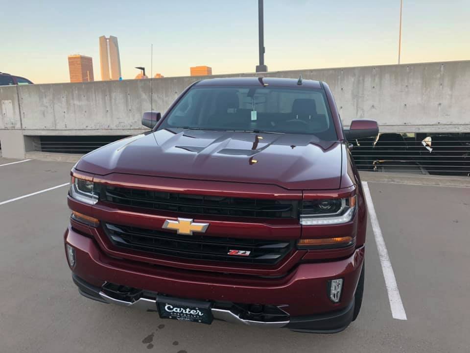

Welcome. I pretty much have same truck in pepperdust. FYI, I’ve had It since new, not sure what kinda shape you front bumper is in, but I already have lot of paint chips from just driving on streets and highways. Have just been using a paint pen to do fill ins. Eventually will have the bumper repainted and put a 3m clear bra on it. If your bumper is in good shape, I would suggest some sort of protection or get a touch up pen ready.
Bumper is chipped pretty good.  Was a repo from a small farm town.  Sure it saw plenty of gravel roads
