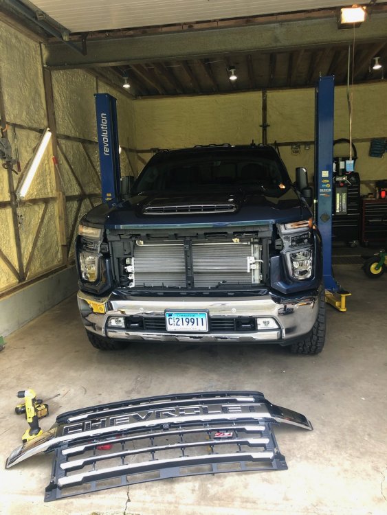

I removed the stock grille, wasn't too bad. You have to remove outer fascias first to get grille off. They have  snap in clips  and one bolt behind the fender flare. Be prepared to buy replacement clips, they are very brittle, snapped a few of mine off pulling fender flare and fascias out.

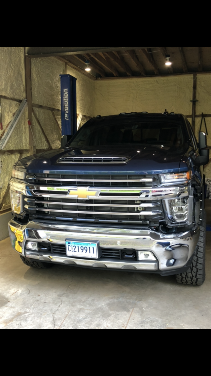

For those of you who were curious. Here is a high country grille swap on a 2020 HD  Ltz. What a difference, The grille is part GM # 84691991 ($963.00) but you also have to buy the lower fascia GM #84678988 ($504). The fascia arrives primed and must be painted to match. Mine is currently at the paint booth getting sprayed. Everything bolted right up and snapped right in.  Granted I do have a ltz premium but I dont think that made a difference. Pic below of grille installed! Any questions on details feel free to hit me up.
That looks really good!
That looks great. I have been contemplating putting the LTZ grill on my LT, gotta like the chrome ??
