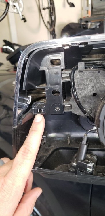

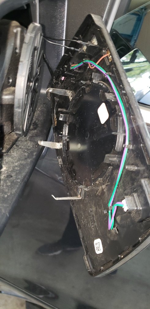

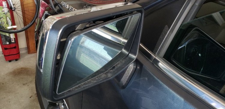

It went great.  You need to adjust your mirrors down and in as far as they will go.  it allows you to see the release tabs.  you can pry the first two loose then work your way to a lower one on the outside lower edge.  Once you get those 3 loose then the mirror just comes off.  The bezel is not as bad as he made it out to the video.  I used two screwdrivers.  One to pry between the bezel and the mirror and stuck another inside the tab slot to pry the tab free.  The inside lower corner sticks and you gotta just pull it till you hear a snap.  Then panic. Then realize its okay.
Getting the old caps off without breaking the tabs will definitley take some patience.  Mine broke, but I think if I ever wanted to use them again, I could.  It might take a dab of epoxy.
Overall the new ones look great.  Took about an hour once I realized how to do it.  The second one went much faster than the first.

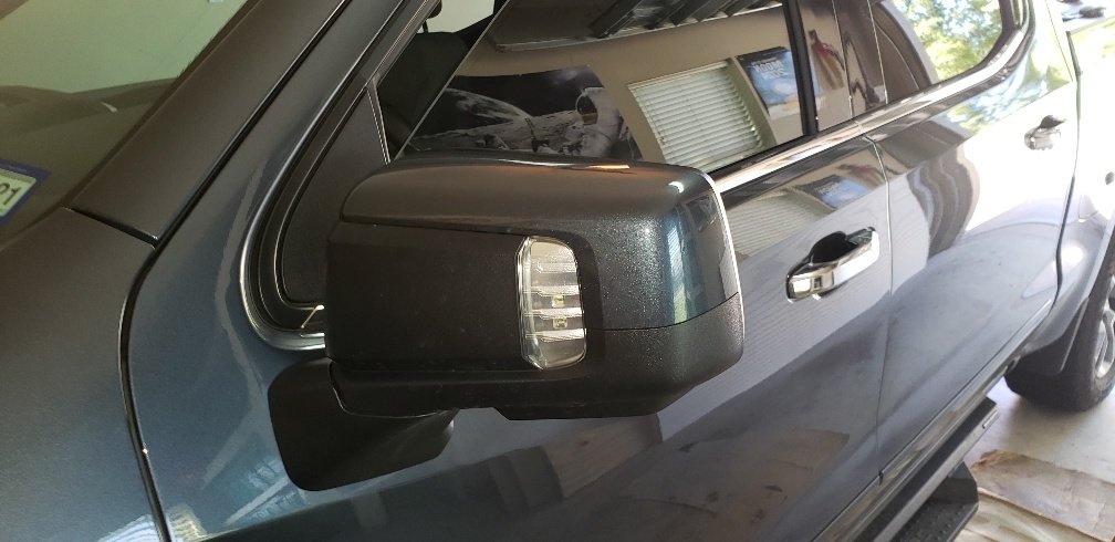

I popped my color matched caps on last night in the dark successfully some how. Oh and check out the freshly painted grille that I popped on last night as well.
54 minutes ago, Raybaby said:
Did you have to take your mirrors apart
No just popped the covers off and put the new ones on. Prob took 10 mins.
Yea I used a flathead screw driver. It broke 2 of the hooked pieces off in the middle (looks like the guy above broke the same pieces and he took his mirror apart) but nothing a little double sided tape couldn’t fix. These caps are one time use in my eyes. They are made very cheap, these cost me like 50 bucks with tax from GM.
Yeah, they are pretty cheap parts.  If I was to do again I might just pry them off.  You can get prepainted ones on ebay for pretty cheap.
