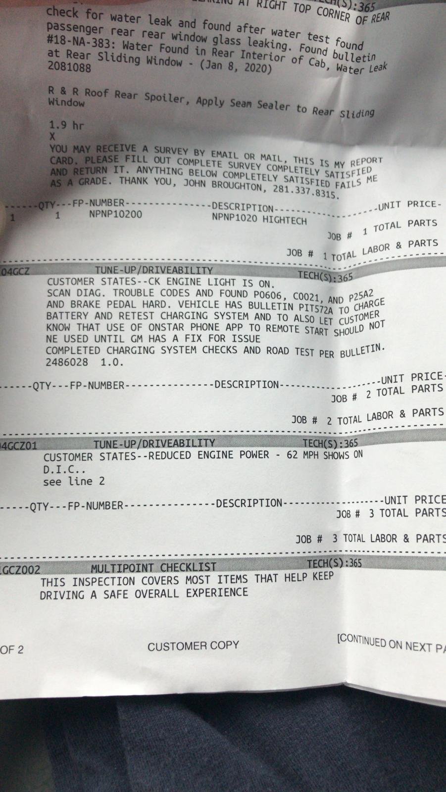

On 1/13/2020 at 7:28 PM, SeTex said:
I drove mine for 6 days with the check engine light on. No issues. Just got mine back today. GM is now saying not to start the truck using the app from this point until they can come up with a fix.
Yeah, just got mine back today and was told the same, I am fine starting it with the remote fob but not the app other than that all is well.

I have been told everything from low voltage in the battery to brake module and now don’t use the Chevy app.

There is an update to the N192268090 recall that will get rid of the loss of brake assist. This update was released on 1/15/2020 and the update was pushed 1/16/2020. This update will take about 30 minutes and since I have had this update done, my 2019 Sierra 1500 SLT is no longer having the loss of brake assist when remote starting the car with the app. They seemed to have fixed the issue.
